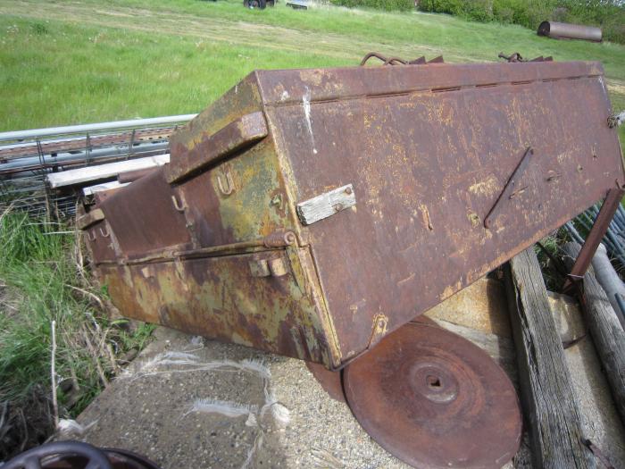

just wondering on the old ford where the numbers are located , doesnt look like there are any plates missing on the dash.It is very complete even the seat covers are still there.

The serial number should be stamped on the side of the frame rail under the passengers door. It's the same as the number on the engine and transmission if they're original.

Here's where the data plate attaches. Bob's right about Fords being the only ones with the number stamped in the frame and that's only on the 11 and 12 cabs.

this is the box for the f15 looks like a 2B1,
shocks on front and back are lever type , the backs are on the inside of the frame.
can still see red paint on wheel nuts
later Anthony

The Australian cab 13 Fords are mostly stamped on the frame either on the vertical or top face of the frame on the drivers side. If it's on the top as most are it is almost impossible to see without taking the splash shield off.
