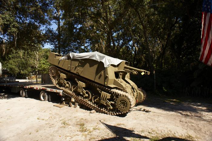

Hi Kids! I thought I would share with every one the restoration of our Sexton.
Here are some pix of her Journey across the states to Sunny Florida!

She was a little hesitant coming off the trailer, but with a little pull, she felt the sand between her tracks and knew she had arrived at the Spa!
