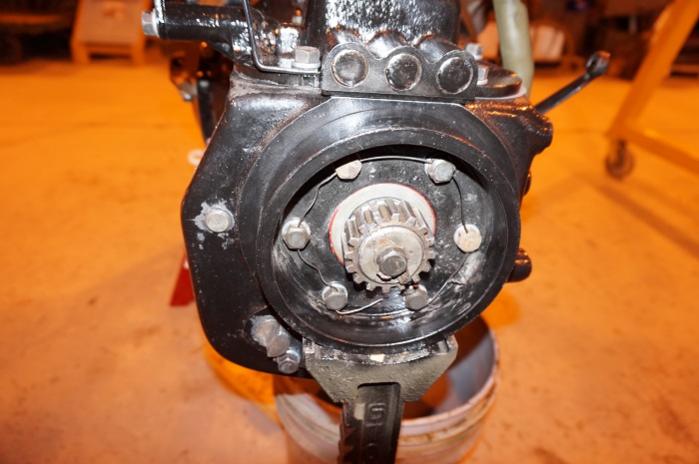

I just bought one or two for the transmission a few weeks ago.
Looking at my orders, the seal was National 473235 which has a shaft size of 1.687 and fits into a bore of 2.623. If you are using a used gear and it has a groove worn into it, you can sleeve it with a speedi-sleeve pn 99168. I got both sent from Rock auto for $6.49 for the seal and $18.23 for the sleeve. With delivery to Canada it was around $40 Cdn. The sleeve alone costs more than that here, and that is with our government discount.
I actually ordered two of the seals because they are thinner, and was going to stack them. In the end I didn't bother since I installed a sealed bearing on both the input and output shafts of the transmission, so there will be minimal oil getting to the seal anyway.
For the seal at the diff pinion, I found that the rear wheel seal for a 76 Chev 5/4 ton was pretty close to the right shaft size. I turned down the coupler to the correct size, then sleeved it as well for a good finish.
I turned an adapter for the 5/4 seal so it would fit into the differential bore. Took maybe an hour and a half to spin on the lathe, but I did slice my thumb a good one in the process on some of the razor sharp shaving.
I have photos at work that I might post tomorrow if anyone wants to see examples. (the seals and retainer....not my thumb).

Some photos I had on file.
Old 25-02-16, 22:29
