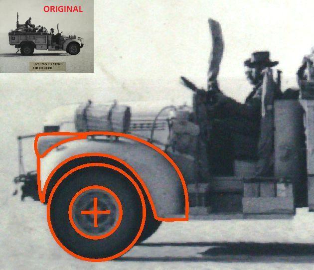

I'm pretty sure the fenders are all the same basic stamping with different size wheel cutouts. The military fenders look wider because the front bumper is mounted several inches higher than the civvy ones. If you compare the fender width to the number of grille bars they're all the same.
David, thanks, I will keep with this point about the width (it is 72 9/6”, for the whole ’41 US built commercial range, acc. to the dealers book).
Although, if to compare the two pics, it is still not clear, even considering the different camera angles.
The side profiles show the significant difference in the aft end location, between LRDG pattern (fwd from the door cut), and the whole commercial range, which had all the same fenders, from pickup to heavy duty trucks.

Igor; the fenders of the trucks used by the LRDG and as well those used by the Free French were widened by approx. 11 cm to accommodate the sand tires. They cut the fenders in the longitudinal direction and added a stripe of sheet metal then.
I have measured it myself at te fender of an LRDG Chevy 30cwt WA at 'Jebel Sherif' and I have seen the same "widenings" at a French wreck and also at the SDF wreck in the Egyptian desert (the one you have presented above).
Old 14-11-11, 11:20
I have measured it myself at the fender of an LRDG Chevy 30cwt WA at 'Jebel Sherif' and I have seen the same "widenings" at a French wreck and also at the SDF wreck in the Egyptian desert (the one you have presented above).
They were widened by 4in (104mm), and it was a factory modification for use with 10.50 wide tyres (on 16", 18" or 20" rims) as per the WD specification, not as your post suggests modified by the troops themselves. I attach two Ford Canada factory pics of a regular C21T cab for 7.50-20 tyres, and an MCP cab, and 2 GM Canada pics of the standard guards for 7.50-20 tyres and the guards for 10.50 tyres.
The spacers to widen the guards are one of the ID hallmarks of an MCP truck.

Kuno, thanks a lot! Now it is clear, the fenders were modified.

Default evrica!
the door on the closed cab was angled on the hinge side as was the cowl of the closed cab to suit the door. The other LRDG Chev Truck is a 'flat' faced cowl and the area where the door hinges would normally be is straight up and down so this is why the guard ends further forward. The dash was completely different between the Flat Face cowl and closed cab as well.
Just today, finally, I cleared the mystery, why fenders do look shorter
Yes, they are the same length, but... higher, or deeper. I outlined the most convenient picture, from the IWM, and mirrored it for more usual direction, and copied the outlined results on another pics. All the same!:

Originally Posted by Igor Shadrin View Post
I outlined the most convenient picture, from the IWM, ...
While undoubtably the wheel openings are larger, I think the stampings used on the guards are also different. Compare the slope of the front of the guard under the headlight, and also the slope at the very rear of the guard:
