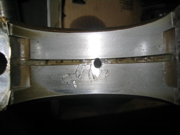

Progress up date-the Engine Runs for the 1st time after rebuild http://www.canadianmilitarypattern.c...9th%202011.wmv . Not bad sounding if I do say so myself, no exhaust pipe, timing not dialed in yet, pulling 17-18 inches, oil pressure at start 42 PSI. No clanking little valve noise but clearances were set with the engine at room temperature just as a starting point. Prelubed the oil system with drill and heated the block with a block heater to 110 before starting.

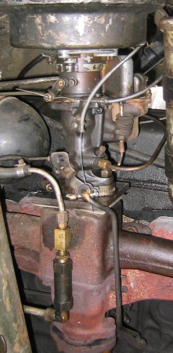

Only issue noted was a drop in oil pressure at idle once engine had equalized at 180F. This I suspect is because of missing restriction orifice in the filter system. See more photos ( http://www.canadianmilitarypattern.c...20December.htm )
Problem is with the T fitting coming out of the block for the filter and oil pressure gauge, original has a restriction orifice in the line to the filter. Has anybody else found one of these. I replace the fitting for two reasons one I could not get it back in position because of the through block oil line. The other was that this same fitting on my Pattern 12 failed early in testing that engine and it emptied the crankcase very quickly.
I plan to run the engine some more to see if it drops below the 15 PSI I saw once the engine was up to temperature at idle. Plan then to put an restriction orifice, with the same size hole as the original,in the supply line to the filter and see if that changes the pressure drop once the engine oil is up to temperature.

Ran the engine for the HUP on the test stand for 4 hours yesterday. Engine started easily and ran very smooth accept at very low RPMs when there was a decided flick to the vacuum gauge and rough note to the engine exhaust note. Possibly a valve that is not quite sealing possible cause in proper valve adjustment. Will need to check the valve tappet settings after next engine test, once the engine is up to fully equalize temperature.
Concerning my last posting about the restriction in line to the oil filter. Took a bunch of fittings and made up a valved bypass to see if the restriction makes any difference in the oil pressure. Simple answer no difference cold oil 40F or 140F open close the valve so oil is going through the restriction or not.
Once engine is at full temperature 160-180F the oil pressure at 400-500 RPM is steady between 7-10 PSI which is a little lower than I expected for a freshly machined engine with all the bearing clearances by the book. But before I get to worried about try a different oil pressure gauge, first the one out the HUP (0-80 PSI range) vs (5-100 PSI) of the gauge on the test stand.
With the engine running on the test stand and the exhaust pipe hard piped out side the engine can be run with the shop closed up. A 216 running from 400 to 1200 RPM and the fan cooling the radiator heats the shop very nicely, the furnace never came on.

Default I went the simple route for hand throttle
Hi Bob
Though all the my normal 216 engines and carbs have worked well with the hand throttle cable end just going through the hole on the throttle linkage see picture below. You will also note that the washer on the throttle linkage has been brazed to lock its position. This picture is of the side of the HUPs original 216 engine before the overhaul started.
But on the 261 Carb the cable is in just enough different position that it would stick requiring a very stiff return spring that was annoying to drive with, particularly as the throttle/gas peddle now actually is used to regulate speed instead of being an on or off switch.
Using the lever arm which is moved when the choke is out proved to be a simple way to set the idle speed up.

Hi Bob
Phil...Tell me a story about the gear clamps..two..that around the base of the carb where it joins the manifold..Holding the spacer block together and in place..??and the 1/2" spacer..and the extra thick gasket ..was the carb sitting too low..??
or is that where the fuel injection hooks in..??
New trick..???
Do tell..

Default The insulating spacer broke
Hi Alex
The insulating spacer broke in half while cleaning water out of the carb on the side of the road one day. Didn't have a spare with me so painted the broken ends with Permatex and put a hose clamp on it to hold it till it hardened, long story short I've been driving it that way for probably 15-20 years.

Hi Alex
When you know what you are doing..what you need..and how to fix it ,a fix is usually what ever you have in the tool box..under the seat or in the glove box..
If you can cobble up a fix and it works well,if some times pay to leave it..although I would always have a new one stashed in the dash somewhere...
Run'er til she breaks again..and repeat the process..

I was intrigued by your experience with the oil pressure readings on your 216. From my observations over many years these engines are unlike any other in the way the lubrication system works. Oil pressure doesn't seem to mean very much.
From my understanding of it, if it wasn't for the distribution valve there would be little or no pressure at all. It's function is virtually that of a relief valve with the oil that passes through the valve being 'dumped' back into the sump via the six big end supply nozzles. Meanwhile the back pressure it creates pushes oil to the main bearings, camshaft bearings and rocker gear. In view of the foregoing I would tend to think that perhaps the value of the distribution valve spring would have a greater effect on oil pressure than engine condition.
I'm not surprised that the oil pressure showed no change when you shut off the flow to the filter as the Military Senior Filter is intended to operate on the bypass principle and has its own built in restriction. The oil has to pass through a tiny hole in the centre tube to exit the filter.
Just a few thoughts on the matter in case you were still mulling things over.

You are right about oil pressure on the splash lubrication 216 engines. The book basically says if the pressure gauge shows any pressure it is OK. But that is only the beginning of the story the oil flow inside the engine is amazing. I wanted to understand this better and when I was building up the 216 engine for my Patter 12 I did all the steps called for in the manual and then started documenting what was going on. Take a look at http://canadianmilitarypattern.com/P...Page%20Two.htm which includes a video of the water test for nozzle alignment.
While testing a 216 one time the tee fitting on the side of the block broke off and in a matter of seconds it had pumped most of the oil out of the engine. Fortunately I was standing at the control panel when it happened and hit the kill switch. After that I did a test by pumping the crankcase pan out using the regular oil pump driven at low speed by a drill 5 quarts of hot oil in between 7-10 seconds.
I'll have to add the video of the 216 running with the valve cover off and the transparent side panel that I use to check the push rod function and lubrication.
The inside of the 216 is literally an oil fog when running above idle as the troughs are emptied by the scoops coming through the actual lubrication is of the lower rod ends is by the stream of oil hitting the scoop, which is why correct aiming of the nozzles is so important. Watched this by putting a clear port over the fuel pump mounting hole in the block.
