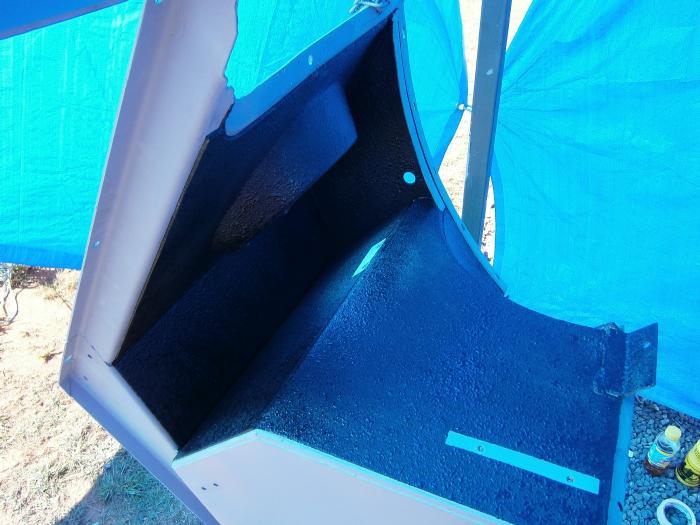

Default Underbody sealer applied to Nose panel
Name:	Nose ready for underbody sealer.jpg
No time was available for CMP work yesterday, so application of underbody sealer has minimised what could be done today.

  #424
Old 13-05-12, 12:54
Default Nose Panel - inside/underneath painted

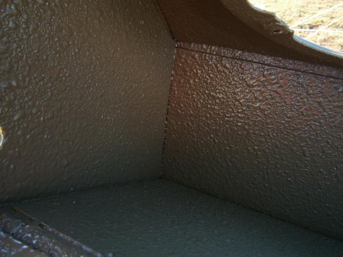

Insides of nose panel are now painted. I had just enough time to get insides and underneath painted before light failed.

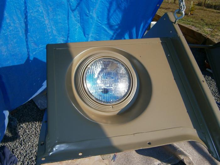

Default Headlights on
Name:	Headlight driver.jpg
ID:	49205 Click image for larger version
Name:	Headlight passenger.jpg
ID:	49206 Click image for larger version
Once the paint was almost touch dry, headlights went on, as did the upper mudguard bracket that sits under nose panel. I also did a very brief trial fitment of the bonnet late this afternoon. As usual, it fits in a way that touches a number of areas where it shouldn't! It also will require addition of a shim under each hinge attachment point. Here we go again!!!!

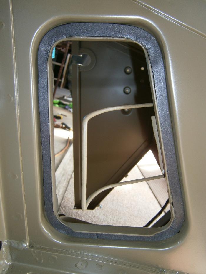

Side vents were treated to a strip of foam seal. Then I began re-installing the vents themselves, and made the re-discovery that hole size of the vent hinge and where it attaches to the nose are very much different. The little 'collars' that were in here had been thrown out as they were badly corroded.
Name:	Side vents 2.jpg

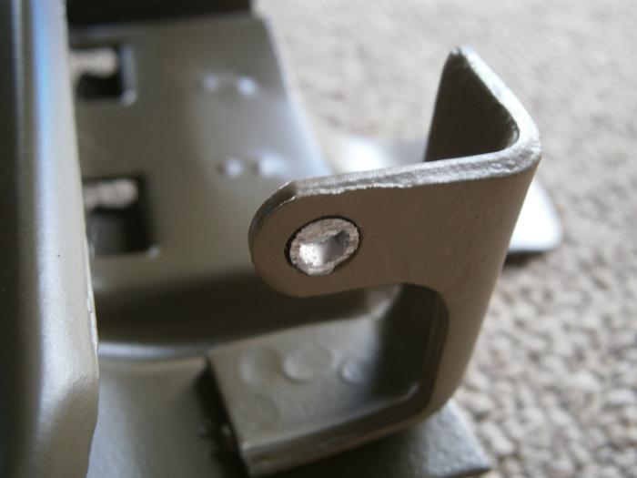

Once in place, I saw that the driver side foot well didn't fit right. The bit nearest the engine cover would NOT go in as far as the pedal plate required it to be. Despite some careful whacks with first a rubber mallet, then a ball pein hammer, and finally a large and loud outburst of swearing, it STILL WOULD NOT GO IN. By now I had caused some damage. Rubber burns from the mallet, and lots of paint removed by the hammer.
The swearing was getting out of hand (so my wife said. I thought it was just right amount), so I switched from english to Italian, Estonian & German. I don't actually speak any of these fluently (effluently ), but I know sufficient curse words in foreign language to get my head punched in, all around the globe!
Name:	Pedal plate installation 2.jpg
Then I had an epiphany. I drilled a hole through the offending parts, and pulled them together with the tightening of the bolt. Propper job! What a shame this didn't occur to me prior to buggering the paint to extent that it will need to be sanded and repainted!
