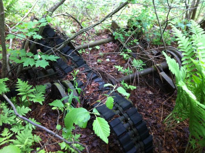

Guys,
I'm Richard from the Carrier and CMP forums. Yesterday, I was chasing down some CMP truck parts and I came across these treads and bogie/running gear in the bush. Some of the treads are have rubber pads and some are steel. Running gear is painted and looks to be in good condition, covered with years of leaves. Rumour has it that they are from an International half track. I am going back to the property on Wednesday. All remaining scrap on the property is going to the scrap yard next week. Does anyone in the armour forum recognize what these are? Should I pick them up while I'm there? Let me know, I would hate to see something go to the scrap yard if someone out there needs them.
Thanks, Richard

The first picture definitely looks like half-track tracks, 3 of them. As for the second picture that is not a half-track track, nor does the frame look anything like the parts from a half-track. The 3rd picture I'd have to say the same as the second. None of those parts looks to be from a half-track. Once dug out maybe more will tell us better
Andy you are right! At first glance I thought regular US WW2 half track stuff but indeed it isn't. I can see a leaf sprung bogie and a different type of track. Must be the remains of one of the pre-war Cunningham half tracks as depicted on this pages like http://mailer.fsu.edu/~akirk/tanks/U...lf-tracks.html and http://www.trucksplanet.com/catalog/model.php?id=1062
Great find, Richard!

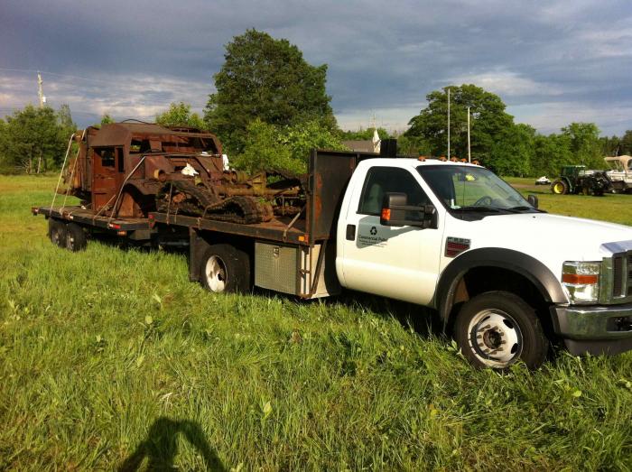

Guys,
Here are some photos from last night's retrieval. The bogie assembly weighs a ton, probably a ton and 1/2! Good news is that who ever dumped it in the bush, greased it first. Everything turns freely and doesn't look to be out of alignment or bent.

Guys,
Here are some close ups of the track and bogie. Is this good enough to confirm that it is an Innes Cunningham?
I'll power wash then oil spray the tracks and put them into storage. Same for the bogies, I'll put a grease gun to the nipples and put it also into storage.
I do not have any plans for the tracks and bogies. I would like to sell them and put the proceeds towards restoring the Wire 5 and the Dumper. Send me a PM if anyone is interested.
