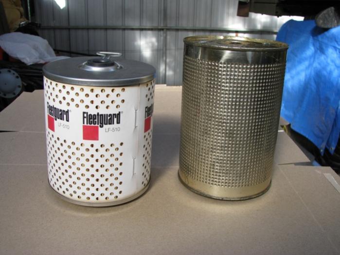

I am going to use the original bypass oil filter on my Ford F15A CMP. I feel some filtration is better than no filtration at all. Not being a hot rodder (or intending to use the truck in the dusty outback) I do not see the need to modify it to a full flow type as is often done- most early civillian Flathead engines didn't have filters anyway. While researching replacement elements for it I found some peculiarities. The ID of the cannister is 4.125". As per the photo of a sample NOS element the dimensions are 3.813" OD x 5.50" long. The closest match I could find for a bypass element was a WIX 51001 which is listed for 60-61 GMC's and is 3.72" OD x 5.50" long.
The WIX 51006 is the one quoted for the flathead V8 and is 4.09" OD x 5.00" long (1/2" shorter). It also seems many filter elements listed for the 40's flatheads have a greater diameter than 4.125" and therefore will not fit, such as Fram C4, OD 4.20" and Purolator L30034, OD 4.21". They often are only 5.00" long too.
The cannister is a different design too, to most US Flathead engine filters, It has female threads on the lid retaining nut as opposed to a male retaining screw on US engines.
This is more for fellow Australian restorers, but I have found the WIX 51001 is not available here but the 51006 is- at a price. I am using a Fleetguard LF510 which is listed for the Flathead V8, and is 3.97" OD x 4.87" long and is available here. Anyone in Australia know of any other elements that fit?

Since the previous post I found the Australian agents for WIX filters, Engine Australia, and low and behold they have some 51001 filters in stock and at just $10.60 each so I got a couple. Even with domestic air freight from Brisbane they were cheaper than the Fleetguard 510 I had bought locally.
Even though they are listed for 60's GMC trucks, Clark lift, and Graymarine applications I am 99.9% certain it is the right one for this particular oil filter cannister as it is identical diameter and height as my NOS sample on the left in the picture. It is a bypass type filter too.
There is a slight difference in the bottom hole diameter: 0.552" and the top hole diameter: 0.480" and when I had a good look inside the cannister there is a thin collar at the bottom which would account for the two different size holes.
It fits like a glove so between the three new ones I have a few years supply of this consummable.

Here is a NOS filter I bought from LWD parts. Other than the first example I had, this one has slight rust from storage (what to expect after 70 years?) so I'll keep it for show.
This is what was listed on the label:
Wix oil filter element
NA/AG 172
Ford C11Q-18663
G.M. 853472
Chysler 923768
Dimensions are (approx.):
Diameter: 96 mm / 3.8 inch
Height: 133 mm / 5.2 inch
