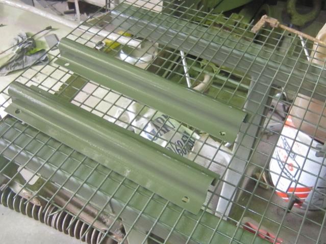

Also made a few fuel tank brackets.

Have you found a supplier for the felt packing on the fuel tank brackets?

Hi all, I'm just keeping South Aust in the carrier buisiness. Euan, I have got a roll of white felt for the brackets and other parts.

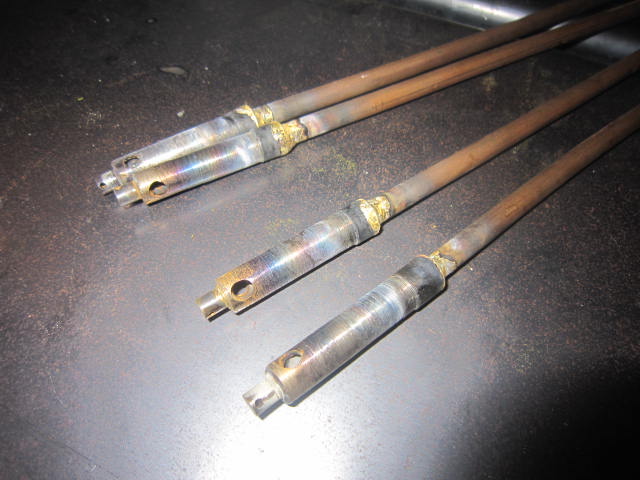

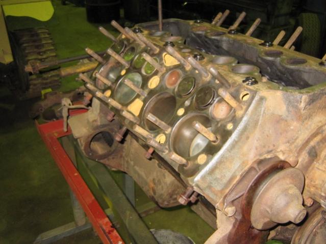

Hi all, the first one is going and driving well and I've just done a valve lap and descale on the engine for the second carrier.This is an engine out of a Jailbar and by the looks of it, I think it has been done up before. Even the engine oil was still clean and unpoluted. This one has the crab dizzy which is a good thing.

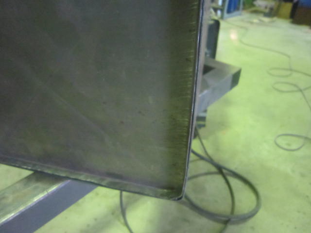

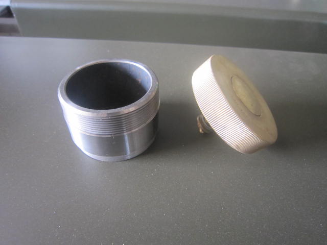

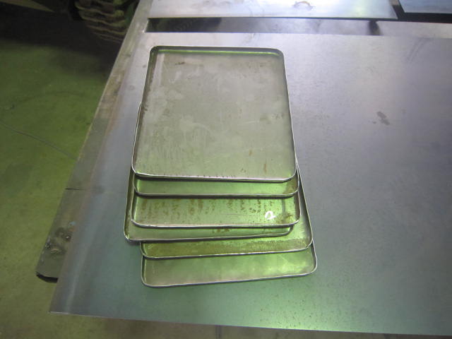

As I don't have any fuel tanks in stock I thought I better make some. I have original caps to give them the authentic touch.
I cut a 10mm thick end template to dolly the end around. They will all be quite exact if you use the same plate. I also fabricated a round bress brake die for the edge radius which is very simple but efective.

Used lots of clamps toform it into shape then a few tack weld here and there. Then all clamps off and it's ready for the next one prior to fully welding.

Hi Colin
Very impressed with the fuel tank fabrication. That is great detail work, what type of metal did you use and what corrosion preventive are you going to use on the inside?
You solved one of my problems on forming the end caps to get the proper curve, also will be useful on the internal baffles.
If you don't mind I like to include your instructive photos in a Tech Tip article for our local MV club newsletter?
Old 14-11-12, 22:40
colin jones's Avatar
Posts: 1,810
Hi Phil, use what ever pics you like. The material is 16g mild steel and I'll coat the inside with zinc phosphate after completion.

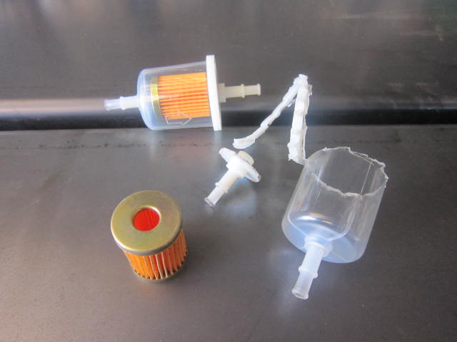

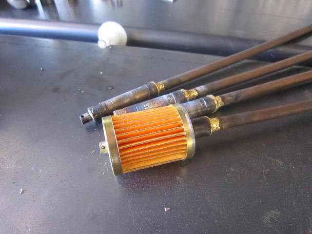

Done the fuel connection and used the filter out of a standard in line one. Easy and cheap to replace.

I followed the original design except with the unseen, better filter that is off the shelf. Sorry for so many pics but they may be of use to someone if they need to do something similar.
Colin

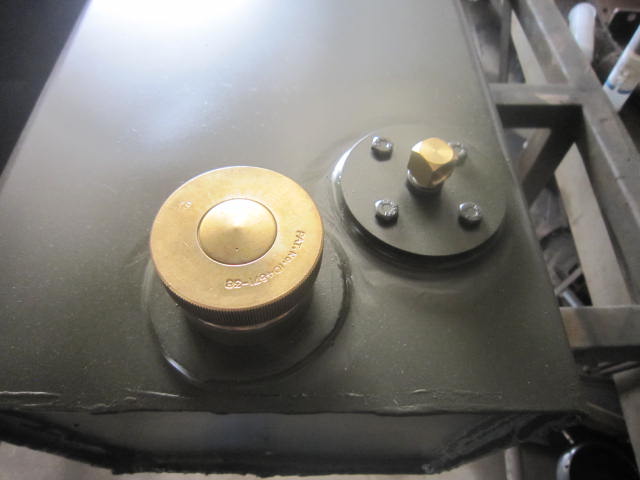

Here's a few pics of the finished tanks. Time to get this carrier running.
Colin.
