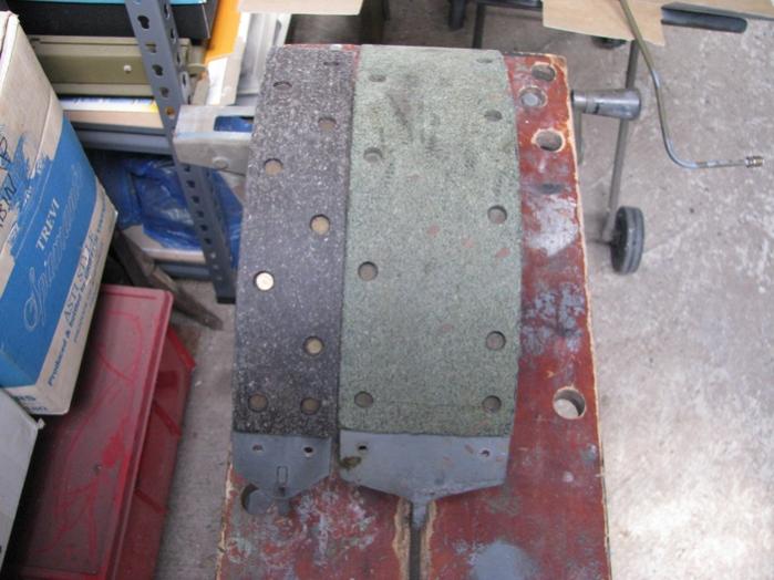

Default CMP brake shoe sizes and materials
Posted here are two photos.
They show a 2" wide front brake shoes as used only on F15, F15A, and F30 CMP vehicles and the 3 1/2" wide rear brake shoes which appear to be used on all other models front and rear according to MB-F1 U-9. Check section however for specifics. The F15 and F15A rear shoes in addition have a pin pressed into the shoes at the top for the hand brake actuating lever.
Note the 2' wide front one is shod with a modern non-asbestos brake lining, grey in colour.
The 3 1/2" wide rear one is a NOS I referred to previously with the greenish/blue coloured lining.
The person who informed me it contains asbestos was running a truck brake business for 40 years and just recently closed shop so I believe he knows his brakes.

Nicely illustrated Jacques. That green colour is pretty.

Yes they are pretty, pretty hazardous to health if ground down to dust!
Jokes aside, I think I may drill out the rivets on the linings keeping everything wet as I do to prevent any airborne dust. Once the linings are off and the shoes are washed down they should be safe from contamination.
So Tony if you need them give me a shout. I have two NOS, and 2 VG used 3 1/2" wide shoes. They are no good to me as they do not have the pins for the handbrake lever as used on my F15A. I have a correct spare set anyway.

Tony:
Took driver side hub off. Easy enough! Took out the brake shoes. Easy enough! Notice my brake shoes don't have the lining along the entire length of the shoe? Why is that?!?! The ebay ones are getting more and more attractive.
Tony,
On almost all drum brakes with the wheel cylinder at the top the leading (front) shoe always has a larger lining on it. The trailing (rear) shoe always has a smaller lining on it. The front shoe provides most of the braking force when going forward. The drag between the drum and linings tends to apply more force to the front shoe and less to the rear shoe when going forward.
In reverse, less speed is achieved which means less braking force is required so the rear shoe has a smaller lining. If the linings were the same area as the front ones you would get "reverse whiplash" when you touched the brakes driving in reverse.
F15-A 1942 Battery Staff

Default Ford CMP truck brake linings-asbestos
As per attached photos the name "Raybestos" on the inside of the linings says it all. It can also be seen faintly in the genuine Ford lining
I decided to remove the linings as per a previous post before I moved them on.
A 34 C degree day is not the best time to be wearing a spray painting mask while doing this but if I stick them back in storage they will remain there for another few years until I get a roundtuit.
Interestingly the used linings which appear grey in colour are the ones shown here so they don't have to be green to contain asbestos.
Jacques Reed
  #956
Old 18-02-13, 05:39
Don't they look enormous by themselves.
A friend of mine who passed away some months ago, had a great stack of these in a heap under his house. All unused, and perfect in every way, with exception of being asbestos.
Raybestos are the brand of my wheel cylinders. As with most things, cheaper to buy from other side of the planet, as opposed to local suppliers.
