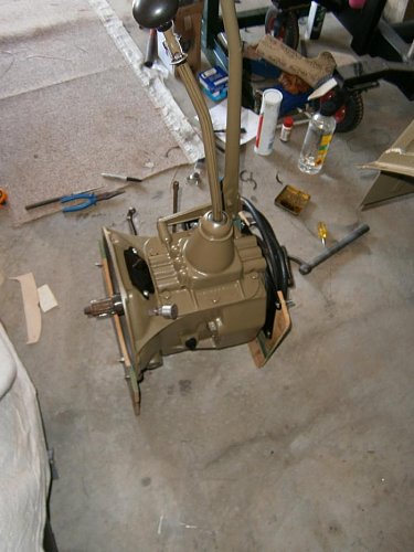

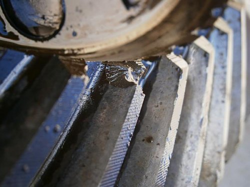

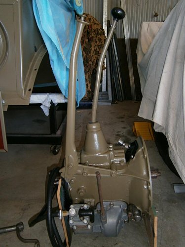

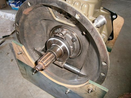

Finished the gearbox today. At least, internally finished. I am still awaiting the following, to complete entirely: clutch rod bushes, rear MDG seal, pilot bearing, locking wire (found enough for the shift forks), and the throwout grease hose. Thanks to Jacques, I contacted Ajays in NZ, and am waiting to hear if they can purchase more of the grease hose. They had run out some time prior and had none in store. Fingers crossed!
Worst part of the whole thing was keeping one of the thrust bearings in place while installing the quite heavy gear cluster that it mates with. I ended up holding it in place with a layer of masking tape around the ID, making sure no tape went anywhere I couldn't take it off again. I was fortunate that all gaskets came off in a single piece, and had no problem making new ones, with the exception of a few minutes searching for the correct thikness materials which were ....somewhere.
Thoroughly checked the shifting pattern, and everything works FINE! Just one little irritance, the reverse lockout rod sticks a little more than I would like (which is NO sticking). That would be my fault, I put the normal amount of paint coats on the shift lever etc.. A little bit if fine sanding may be in order if the graphite grease I applied doesn't work well enough.

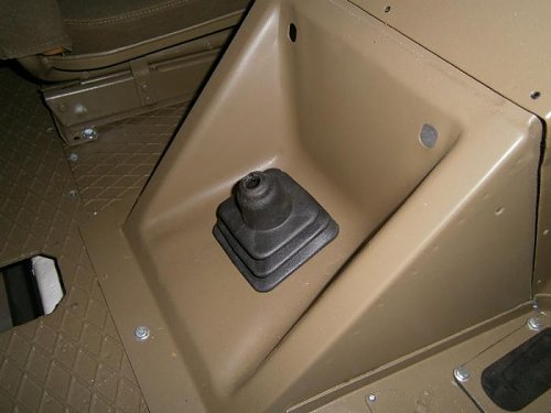

I cut the unwanted portion from the gear lever boot, and did a trial fit. Looks OK, so it will stay in place, and I will attach it propper at a later date, when I need a 'time-out' from soething else. You know the Time-Out scenario? That's when you have to stop whatever you are doing that isn't going well, or you risk bringing a 12lb sledge down onto it.

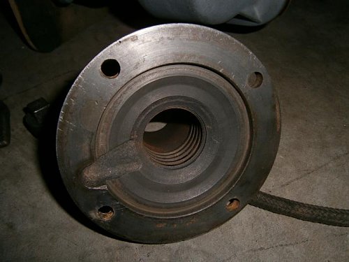

Getting back to the discussion on sealed VS open bearings. I have decided to leave both of mine sealed. At the front, oil will still get past the bearing, Just in a much reduced quantity. The grooves in the slinger will hold some, and friction should be minimal there anyway. I chucked a handful of light grease in there for startup.

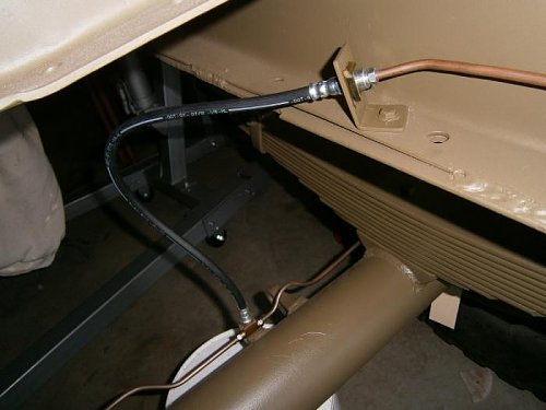

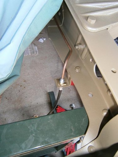

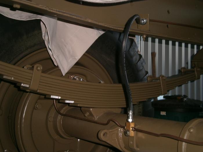

The post-office pickup slip description which I thought may have been the long awaited wiring loom, actually turned out to be these two brake hoses, in a very well packed (and somewhat enlarged) box. This pair of hoses are the ones that go to front & rear axles. They were custom made in USA, and cost $50.00 including shipping, for the pair. They even came with the locking clips and copper washers. Now that I have seen the quality, i'll call the supplier and order a new pair for the front axle to wheel cylinders.
I had initially offered the local brake repair shop the job of making these (and two others), and I left a sample hose with them so they could get the right ends. That was 7 weeks ago now............Their loss!
I should actually have gotten more done this weekend, but we bought a new ride-on mower on Saturday, and I decided to tidy up the place first. This one goes a number of times faster than the previous, lethargic one. That includes in reverse too!! Naturally, when Gympie finally secures the Hardie Ferodo 1000 (or whatever Bathurst is called now), I shall enter immediately. In the years BC (Before Children), my wife & I took a detour to Bathurst while on a driving holiday, for the purpose of trying our new sports-car on the track. Well OBVIOUSLY I didn't make too much of a point of the track trying bit. As it turned out, I was saved from a very expensive speeding ticket by another motorist who flashed his lights to say there was a police radar set up on the downhill straight! For you foreigners, the 'Bathurst 1000' is a 1000km race on a closed public road that then becomes the racing circuit. Keep your NASCAR, our vehicles can turn right, as well as left!

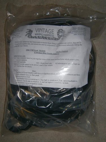

It's here!

  #1030
Old 22-03-13, 16:28
Default Ford CMP Wiring Loom
Hi Tony
Tell us more about your wiring harness supplier, there are so few of them around that actually can or will duplicate CMP harnesses.
Please, as you get into laying out the harness and installing it take lots and lots of pictures.
Look forward to seeing this major step in your restoration process.
Hi Phil,
See Sources for wiring looms for a listing of suppliers, including vintage wiring harness in Australia
Note: when clicking on the links to the related threads, please substitute .net for .org in the URL.

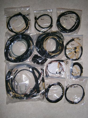

Will do, but first I have to find more information on the exact positioning for each wiring section.
Some time ago, there were some photos posted by Keith, with regards to wiring running along the chassis, and that is the only part I can be sure about for now.
Should have some photos that help. Just a matter of sitting down & looking through them for clues. Then of course there are the various manuals I have bought over past 2 years.
I had a good look at a number of the individual sections of the loom last night. They are best described as WOW! Fantastic quality and excellently built. You no doubt already know I have no time for poor quality service or materials. The guys at Vintage Wiring Harness are very easy to talk to and certainly know their stuff. The build quality is superb. Everything is just so neat and tidy. At less than $600 for the harness (before GST/VAT) they are also very competetive.
http://www.vinwire.com.au/

Tony All the wiring harness that Vintage have supplied to us for several vehicles have come with instruction sheets, and the best deal we got was to send "old harness " and they rebuilt it to new condition at about 1/2 cost, admittingly they were post 1960 vehicles but still cotton wrapped. highly reccomend.
macca C15 C15A
Maybe I should clarify. A set of instructions was sent with the wiring. A photo of that is in my post of 1900hrs, yesterday, 4th pic. That information relates to the assembly of the individual components of the set into the complete wiring harness. Each wire package is labelled as to it's purpose. This can be seen in the 3rd photo of same post. Each individual wire is numbered. The number labels can be removed without problem or residue. Though i'll test that in practice, at a much later date!.
There was no possibility of me supplying an original harness. There was very little of the original one to salvage, and it was heavily caked in oil and mud. The new harness is reproduced from an original harness that the company obtained years ago. I have no fear that there will be errors, but should an issue arise, there is support from them to rectify. This is one of those times when I was glad to spend such a sum of money, in order to get the finish I want.
The information I need to find is the physical routing of the wires themselves, not how they go together. Vintage Wiring Harness has taken all the angst out of that.

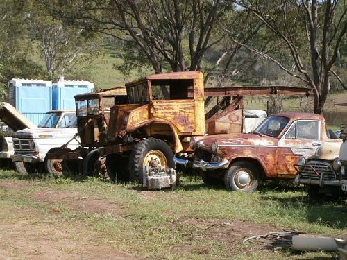

Default Paddys farm, clearing auction.

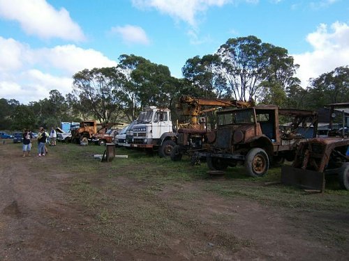

Today was the farm clearing auction for my late friend, Paddy.
Name:	Auction day 1.jpg
ID:	55902 Click image for larger version
Name:	Auction day 2.jpg
ID:	55903 Click image for larger version
Name:	Auction day 3.jpg

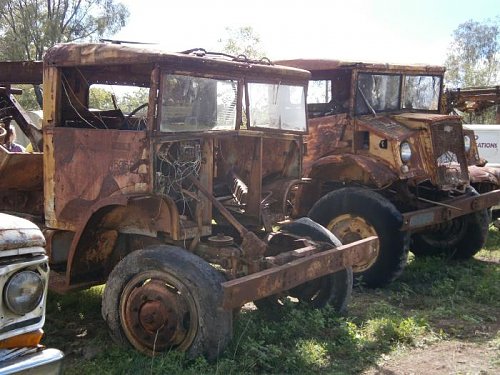

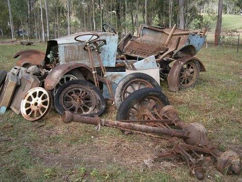

There were several of the very incomplete CMPs included in the sale, but others were not included, and remained in there original locations around the paddocks. Probably because they were too far gone to be of ANY use. The three that were included are sorry wrecks that could provide some minor parts, but not a real lot. The exception to that rule is the doors, which are still quite restorable. I had left before the trucks came up for auction. It was so bloody hot there, we were melting, and no point hanging around for something I wasn't gonna bid on anyway. I'll phone Paddys brother in coming days to enquire of prices paid.
Name:	Auction day 4.jpg
This Morris Cowley was a vehicle Paddy intended to restore. So he said. Can't help but think that even if he were in good health, he may not have got it finished in one lifetime.
While wandering around, I noticed a Ford CMP front end that had the lifting attachment points on the wheel hubs. I need a set of these, so I hope I can do a deal for those before the remaining steel bits go to the scrap merchants. I fully expect that the plans are already made for the disposal of the remaining salvagable scrap.
Name:	Auction day, Harrier .jpg
On the way to Paddys farm you travel past this Harrier Jet, made almost entirely of corrigated iron sheeting. Made a point of taking a photo.

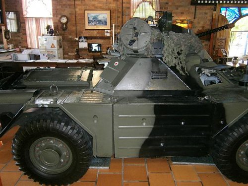

Default Maryborough Military Museum: 1 of 2
After leaving the farm sale, we went for a drive to Maryborough, and made a visit to the Military Museum there. Quite a good attraction. Small in size, but large in exhibits.
ID:	55907 Click image for larger version
I drooled over this Ferret last time I visited, and today just increased my desire to buy one some day. This one is in very good condition, inside & out.

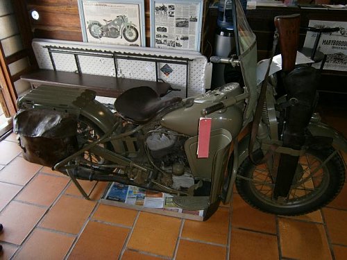

Nice motorcycle!

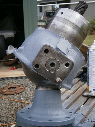

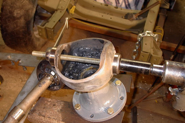

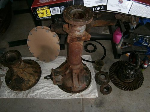

I finally got back to disassembling the front end. Driver side steering end is off the axle/diff, but I have failed to pull the upper pivot pin out. Bottom one came away OK, but despite a number of approaches, top one wont budge. There is evidence of corrosion around the edge, so no secret why its firm. May call on the bearing shop in town. If I can lift the bloody thing into the car first! Both hubs are off. The wheel hub nuts were in perfect condition, not butchered by the dreaded cold chisel removal in past. So far, the bearings and cups I can see look to be in good shape. They will get replaced regardless, so long as replacements can be found. One part that I am worried about is the large grease seal that sits inside wheel hubs. Its about the biggest seal I have come across thus far. They are worn and cannot be trusted to do their job.
Driver side brake backing plate is welded, as I think I had previously stated. If I fail to remove the upper pivot pin, I may consider total replacement ot the entire assembly on that side. That will save me ages of work grinding ofr the backing plate.

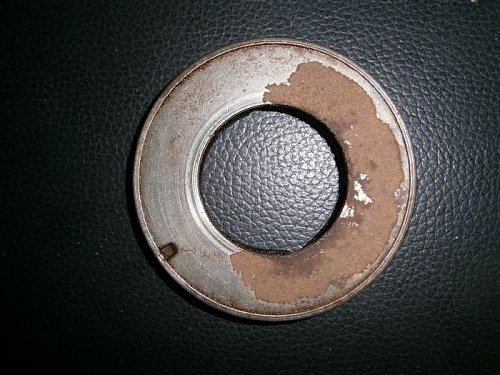

Passenger side backing plate thankfully NOT welded, but I found something very interesting when I had gone over it with a bit of steel wool & petrol. One one side was stamped RF. I gather they are 'sided', so this should really say LF. Curious! The hub had the L stamped wheel nuts and bolts. Thought I had got the whole thing Bass Ackwards for a little while. Petrol fumes must have dulled the brain a bit.
Was informed of two sources for replacement felt seals for steering knuckle. Will order these on Tuesday. All going well, the sandblaster will be doing alright during next week too.

ON the front pins that are hard to remove.... if memory serves me right there is fine thread hole on the centre..... find a suitable....odd size something like 7/16 fine thread and build yourself a puller using the other four bolt holes on the cap...... may need some heat to free it up.... but it will come out.
On the large front hub seal.... there are still being made for commercial application...... do not bother reading the part numbers.... a good bearing/seal shop will have access to a search engine on their computer and they will match dimension ID/OD. Last time I got some the part guy was apologetic for only having one in stock... the second one was there in 48 hours....... all for $19.95 each..... but will be more down under with shipping. Too bad they welded that backing plate... ridiculous really and will give you a headache.
Wonder if you will find stripped bolt holes to account to the welding.
Good luck.
  #1040
Old 31-03-13, 04:50
Cameron Reed's Avatar
Cameron Reed Cameron Reed is offline
Cameron
Join Date: Apr 2010
Location: Australia
Posts: 54
Default seal no
Hi Tony
The seal I used in mine was a Chicago Rawhide no 58741, it was the closest my bearing man could come up with only difference was it is a little thinner,
I think it is 3/8" wide as against 1/2". Probaly worked better for me because the spindle was worn quite wide where the old leather seal ran and i could put the new one in a little deeper to be back on the good part on the spindle. They are a modern type twin lip rubber seal.
As for pulling the swivel housing pins out I just used a 1/2" socket with the id bigger than the pin dia and a 1/2" unf bolt (mine were tapped 1/2"nf, had to run a tap down them to clean them up) place socket over and screw bolt down into pin and continue to tighten. The thread is only short so with an assortment of washers and spacers you'll get there works well up until the pin starts to turn, but then you should be able to get it out

We built ours out of flat plate stock using the existing holes with bolts.... but could not find a picture of it.
Re-installing the NEW Departure bearings we used a large threaded rod and large washers..... worked very easy.....

  #1050
Old 02-04-13, 12:50

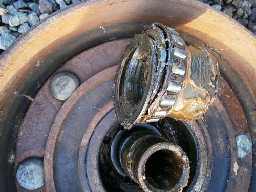

Default Ford Front End disassembly finished
Finally finished all the disassembly I can do on the front end.
This is the bearing from inside the wheel hub. So where does the outer wheel seal go??? I didn't find any other seal apart from the large one around the axle tube, Which I thought was the inner seal.
Name:	Wheel bearing outer.jpg
Or is the inner seal this one from inside the axle tubes themselves?
Name:	Front & rear axle tube oil seal.jpg
The steering assembly on passenger side was easy to clean up without that bloody backing plate that's welded to the driver side.
Name:	Pivot passenger side 1.jpg
This isn't good. Several teeth are like this. The chunks must have been flying around inside there, doing all sorts of damage, but by the time I got the truck there was nothing bigger than fine filings inside. The crown wheel has hit on the side of the casing, leaving a huge scar and more missing metal. Would this have been as result of a catastrophic bearing failure???? Current bearings are not damaged, with exception of some very mild rust pitting where oil had drained away from during long periods of storage. All bearings & seals will be replaced in the diff and axle housings. The CV joints will be OK as is. No indications of damage there and they look fine as far as I can tell. I flushed the steering ends out with petrol and looked inside with a flashlight. It's gonna take a massive amount of grease to refill those knuckles again.
Name:	Crown Wheel Boo Boo.jpg
