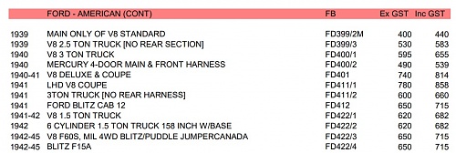

I got an update from Vinwire:
Unfortunately the website price is not up to date at all - the previous owner, who we have just bought the business from, had a few price increases over the last few years & never updated the online pricelist.
There is roughly a 6-8 month backlog of orders at this stage.
The price for the 1942-45 F15A wiring harness went up from to advertised price of A$650 (date accessed 21-apr-2024) to A$900 excl. GST ( ) Add postage ($85-$100) plus import duties and I would have a landed cost of roughly EUR 775.
I going to consider some other options too...
