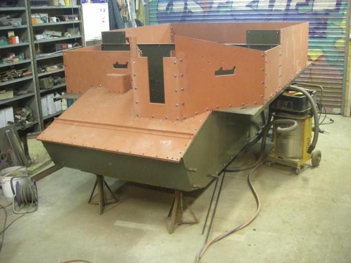

Siemon is making good progress!
All the parts in red oxide is newly cut plate.

I went to visit Siemon last Saturday. He's making very good progress on the Carrier. There's a more complete one nearby from which he copies many parts, striving to manufacture them as original as possible.
Here are some pictures he wants to share with MLU:
1) After sandblasting, the upper armour was measured up and fitted:
Bren carrier stralen 10-11-2012 028.jpg   bren carrier 22-3-2012 031.jpg   bren carrier 22-3-2012 035.jpg

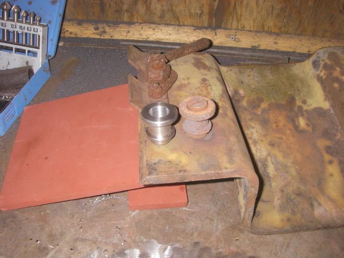

5) Hinge and knobs were fabricated, too.

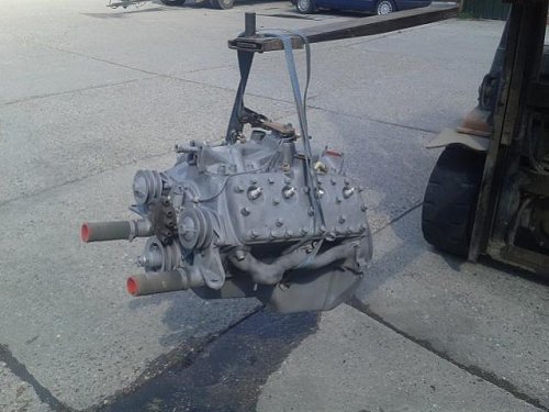

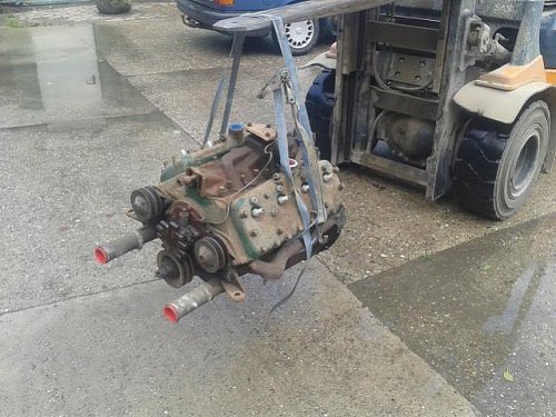

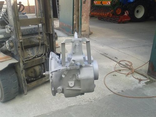

Update from last August...
Engine (ex-F60L) and transmission being prepared to go into the Carrier:
ID:	70070 Click image for larger version
ID:	70071 Click image for larger version

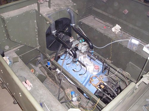

Old 27-12-14, 16:29
Siemon got the dimensions off MLU and finished the mudguards.
Here's a video of the first starting up of his carrier: http://youtu.be/n9mLQBebnWY
PS: note the "special" exhaust system
