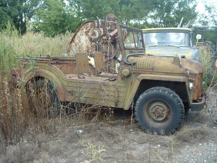

I was offered these two Austin Champs locally for 2K for the pair. One "runs" and the other is for parts.
Should I stay away, or?.....

There are more parts in a Champ back axle than that whole '34 Dodge dump, David
You might want to rescue them, park them in a corner, and sell them on, but that's as far as I would go.

They do have some good points, and I have never regretted going down the Champ path.
From the pics 2k is about $1500 too much.
Your main supply of parts would be in the UK, which is going to factor heavily in the cost of parts. Nearly everything is still available, mostly NOS, some repo.
Rusty sills are a common problem.
The motors are a B40 Rolls Royce (made under licence by Austin) and are generally a long lasting unit, fully waterproofed, which also adds a little complication.
Torsion bar suspension all round, which provides a comfy ride, but there are a lot of moving parts to look at during a rebuild.
Transfer case is integral with the back diff, it is not of the High/low variety, but supplies a change in direction: giving 5 forward and 5 reverse gears.
Most back diff problems were resolved during service life ( I see they are military, not the rarer civilian model).
I could go on for sometime, but I will spare you. Yes they are a complicated little beasty
but I imagine a right hand drive Rolls Royce powered convertible will help you stand out from the crowd, but there will be a fair bit of work involved.
If you have the vehicle No. (on Brass plate, upper firewall under the hood, passenger side,) you should get a little info from the register:

A sensible answer for David to work with! Nicely done. My comment on parts is, of course based upon having to source internationally: no 'quick fix' when you are in the USA.
Was I right with regard to the back axle? What were the problems they had in service?

The head of the Champ project was asked to go to the US and explain the diff issue that was giving problems to the vehicles on trial there. He was adamant that all the problems were due to lack of oil, either due to poor maintenance, or possibly the sealing of the PT0 cover on top of the back diff. The studs were long enough for the proposed winch fitment (which never happened), and a little long for the cover supplied. This minor problem could be fixed with an extra washer under each nut.
Totally unrelated to his report, I'm sure, back in the UK orders were issued to replace all crown wheel bolts with a higher tensile grade, and all driving flanges on the hubs modified for a further three bolts.
My personal opinion is that despite a long and expensive gestation, the Champ was pushed into full production before the results of the extensive trials were acted upon, in an attempt to save the British Fighting Vehicle concept which was rapidly losing favour. As a result, the problems plaguing the early production Champs gave it an unenviable reputation that still exists today.

.. and I emphasise Richard's point about complexity. Not only are they complex, but they are not simple to maintain, which compounds the problem.
The rear diff is the usual talking point, but I suspect this fault was the result of driver error/stupidity (call it what you will), combined with a post Service lack of lubricant. I found one rear diff which had the pinion teeth worn to fine points and a sludge mixture coating the interior of the carrier, which apart from the sludge, was an oil free zone.
It is a fine vehicle if looked after but it takes more looking after than a normal military vehicle should.
David - the one you've shown us looks to be remarkably complete, but I echo the others who have commented that the price is far too high.

Jack, I sat down and carefully read through all your restoration posts on HMVF tonight until about page 6, then I honestly developed a cold sweat of sorts!
I don't have the will, time or money to invest in the efforts to put into a new Champ project. They are very cool vehicles, but one has to REALLY want to restore a vehicle to see it through to the end....
Having said all this, if anyone want these Champs I will do my best to convince the owner to lower the price to a reasonable level, and get them into the right hands...

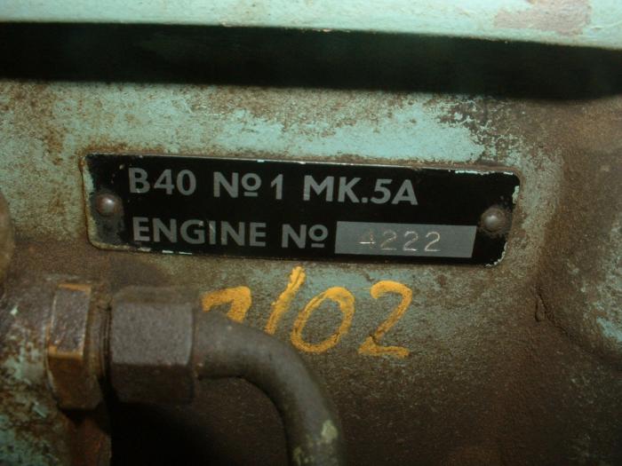

Courtesy of Stuart at the Champ Register:
Chassis No: WN1-2380
Army reg: 23 BE 80
Engine No: 4222
Date into Service: 1st April 1953 when received from Austin at the 31st B Vehicle Depot Church Broughton, part of the 3rd Vehicle Group HQ, Church Broughton in Derbyshire and given Receipt Voucher: CBR/R/3 (Note: It was one of four Champs delivered under this RV number)
Struck Off: 8th May 1968 from BAOR (British Army of the Rhine) - This is one of the last Champs to leave service - 2 or 3 years after most had been removed.
Sold: Probably at auction in Monchengladbach a few months later.
BAOR service explains the low slung reflector at the back.
Interesting to see if the original motor is still fitted.

Richard: Thank You for finding the history on this Champ! It's certainly has travelled a long way from home, hasn't it?
Looks like your group is putting those Champs through their paces in the video...and it also appears they are taking it well! They look to be very rugged vehicles, but this one will never see any off-road use.......unless I win the lottery and can afford to repair it.
Oh, and engine is original to the vehicle..

The indicators on the windscreen frame are original, can't say I have ever seen any here in OZ.
Appears from the pics that the previous owner has done a lovley job making the front bumper straight - they are supposed to be bent inwards at the centre.
You made mention of the rec'd fuel tank, is the bash plate among your spares?
Pretty normal to still have the original engine, but neat all the same !
You could join the Austin Champ Owners Club ( has the rather doubtful acronym of A COC), the award winning Champ World magazine is well worth the subscription.
Rich.

Default picked up the other one this weekend.....
Thanks Richard and Keith for the reply!
Picked up the other Champ this weekend. Was a 6-hour round trip, but I consider that a fairly 'local' haul for here in Texas.
The second one was a parts donor for the first, but still has potential as a restoration project if someone was really motivated. It is also fairly rot-free except for the battery box. There are no brass data plates or engine tag present on this one. Is there somewhere else to look for identification numbers?
"Bubba" was definitely smoking something strong when he decided to turn his modified front bumper into a muffler on this Champ.
The second one appears to have been disabled for some time. Had two Willard-brand batteries installed... I think they have been out of business since the early 60's.
At least the first Champ I picked up now has a new sun-baked buddy to keep it company, although it doesn't look too willing to play at the moment....

Old 26-08-13, 08:41
Posts: 1,237
Lots of good bits still left on your donor vehicle, I think it will prove invaluble.
I assume the front bumper was also used as a portable Barbie Plate ( not sure what you call them in Texas) for cooking sausages and steak, it would certainly get hot enough.
Some Champs have a number stamped on the top front of the chassis behind the bumper, however this appears to be just a manufactures number and has no relation to the number of a completed vehicle.
