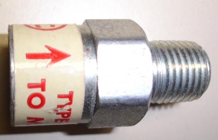

Jordan, This might help? The Ford flathead ones rely on gravity (have no spring in them) so they have to be mounted vertically (and the right way up)

Jordan,
The attached shows the Chevrolet setup. This valve also has no spring inside it, but is helpfully marked with an arrow next to the word 'UP'. It is a sealed unit, but I believe there is a later type that screws together. I could find no part number on my valve, but it is marked with 'Donaldson Co. Inc., St Paul, USA', if that helps.
Check out sections K4 and K5 of the MB-C1 maintenance manual for some more info, including a schematic of the valve.

I have one (and am also looking for a replacement) similar to what Owen posted the picture of.
Markings on it are:
near the "UP" - " DONALDSON CO INC ST PAUL U.S.A. "
near the bottom - " U S PAT. 2120050 CAN PAT 378550 "
Brian
