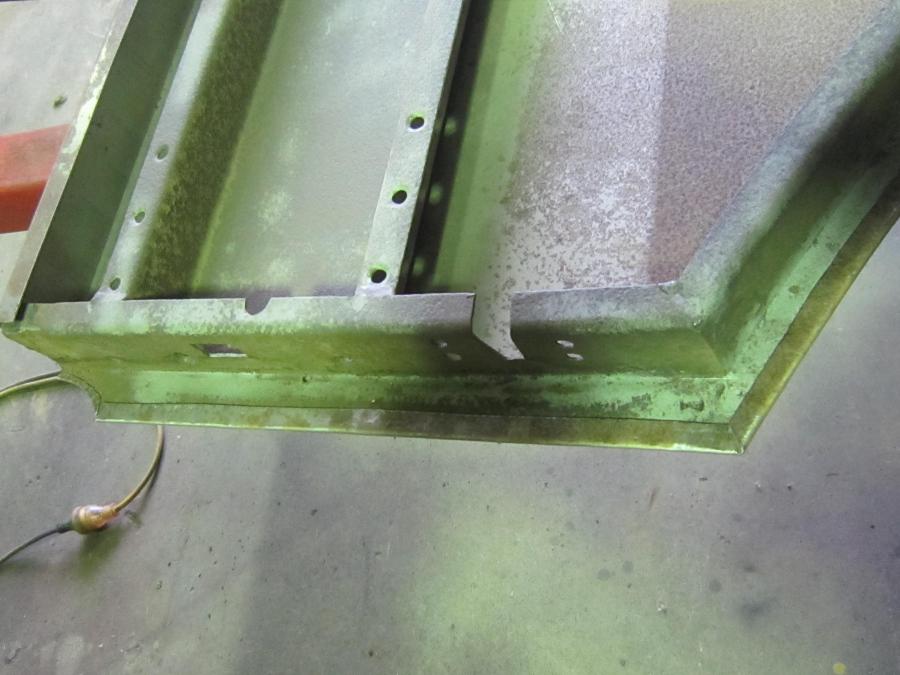

Hello everyone! I don't want to hijack Shane's thread here but I'm re skinning his doors for him and making some hinges as well so I thought this would be the best place to show how I made them.
The hinges are probably quite hard to find but not too bad to make if you've got the tools. I had 2 pieces of 30mm blocks and milled a hole through the centre giving me 2 half round dies. The pin is 1/4" so I welded the pin to some plate to use as the former in the press.
Shanes doors 001.jpg   Shanes doors 002.jpg   Shanes doors 004.jpg   Shanes doors 005.jpg   Shanes doors 006.jpg

I used the other part of the block to press down the rest of the hinge. I did all the pressings first then into the milling machine to cut the slots then a couple of bends, insert the pin, bit of a grind and that's it.
Shanes doors 008.jpg   Shanes doors 009.jpg   Shanes doors 010.jpg   Shanes doors 011.jpg   Shanes doors 012.jpg

De skinning the doors were quite easy with the flap disc in the grinder. I simply ground around the edge until I saw the lamination and the skin literally fell off Well almost. I drew around the door and just allowed the extra for folding over.
Shanes doors 013.jpg   Shanes doors 014.jpg   Shanes doors 016.jpg   Shanes doors 017.jpg   Shanes doors 015.jpg

I put the door blank in the folder and did only 90deg bends as anymore than that and you would lock you're self out. I also gave it about 1-2mm all around so it wasn't too tight. I clamped it to my table and just slowly went around and bent it over. You can't bend it all at once or you will distort the sheet so just follow along and bring it flat including the curves.
Shanes doors 018.jpg   Shanes doors 020.jpg   Shanes doors 021.jpg   Shanes doors 022.jpg   Shanes doors 023.jpg

And that's about it apart from fitting the hinges.
Shanes doors 024.jpg   Shanes doors 025.jpg   Shanes doors 026.jpg   Shanes doors 027.jpg   Shanes doors 028.jpg

Bob, to answer your questions. To make the half circle die is very simple to make without a mill. I used two separate steel blocks about 2"x3"x1" put them together and drilled a hole at the centre where they touch. if you have a pedestal drill I would suggest to pilot drill a 1/4" hole first and then use the full size drill you need. The drill size you need is!
Pin thickness= 1/4" or 6mm or what ever you're using
Thickness of material x 2= about 14mm or 9/16
After it's drilled, pull them apart and you have 2 half circle forming dies.
Don't forget to centre punch the location before you drill the pilot hole.
Believe me bob it is that simple if your using mild steel. Don't forget you're not going into production so mild steel is fine. A general garage press is more than sufficient to bend these.
I never used any heat at all to bend any part of the doors. Cutting the individual fingers with a band saw, hacksaw, jigsaw, reciprocating saw is good if you get the required end result.
Door skins!!~
Four skins will just take you longer and probably more painfull
I used 1mm thick and just laid the door on top before I deskun it and traced around with sharp chalk. I used my 5" grinder with a very thin blade to cut the sheet including the big curve about 1/2" outside the perimeter. but I had to measure the top accurately and allow for the bend radius which is about the thickness or the sheet per bend. I pre drilled the 2 holes at the top for the window frames and then folded the 2 top bends.
If I never had a folder I would clamp 2 pieces of flatbar with the material in between and very slowly hammer over with a wide head hammer.
I used a few clamps close to where I hammer and move them frequently
I never used any heat at all and the curved section is just the same as the rest but just don't try to bend high angles all at once. On one door I did use the spot welder as that is what was done to that particular door. The other one is quite different so they were made by different suppliers.
I also use anything I have to use as bending dolly's like flat punches or pieces of round rod.
I hope this helps and you'll never learn unless you give it a turn.

Mate i am lost for words you truly are a genius Amazing that you are self taught and can produce such work im blown away Mr Jones. Cant wait to come over and see them how does Wednesday sound after you have dropped the kids off to school? Im a very happy man
Thankyou so much Colin

Colin, you do fine work! We may have to call you "Sir Colin" from now on!
Good description of the door hinge failures over time. I have seen lots of Cab 13 doors here in Canada with the same problem and they have a much more robust design. Seems the driver side door shows more failure than the passenger door. I suspect decades of people using the door to pull themselves up into the cab and lower themselves out, by grabbing the top of the door takes it's toll.
