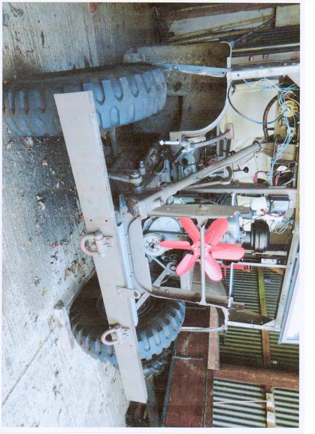

Sadly I had a shunt on a convoy last weekend. I now have an unexpected winter project! I'd appreciate body dimensional data for the front end as I'll be involved in body pulling work.
I ran into the back of a GMC Jimmy and stoved in the front end, wrapping the rad against the engine, thus pushing the front panel badly out of shape. the front doors have impacted the 'B' post, which needs limited pulling.
What I'm in need of is the correct dimensions of the windscreen (A post) pillar angles and dimensions to ensure we get them absolutely right.

I've taken several photos which should help. I've just got to figure out how to load them onto the forum.
The angles I'm after are: the A post (windscreen pillar) back edge to the underside of the roof gutter. And the angle of the forward edge of the A post (windscreen pillar) to the vertical section below (to which the front Bonnet/wing assy attaches).
Any help much appreciated.

Will start measuring tomorrow, I've printed out your photos and will try and plug in some of the angles and measurements that might help to get started.
From the photo bellow it looks like it pushed the grill in a good eight inches. Did it shift the body back on the frame as well? Do you have the frame measurements to check that it is square?
Name:	C8adamage3013 Jerry Hill.jpg
Obviously this crunched the radiator and fan does it look like it moved the engine back?
Now what year is your truck and does it have middle doors on both sides?
Are the front doors still operable or do you need opening measurements?
If someone else could confirm the measurements from another HUP or HUW as a double check of my measurements that would probably help.

Phil
I haven't checked the body mounts, but will after we complete work planned for the coming weekend.
I've opened the bonnet (hood) and the rad is wrapped around the fan blades/water pump. The top tank looks good. I'll see the lower tank situation at the w/e alongwith the bottom pulley situation. At this stage the engine does not appear to have shifted.
It's '43 HUW and has two central doors (pre-dating the spare wheel variant). The B posts have both been slightly pushed by the doors distorting at the striker plate. We can pull both b posts out without too much difficulty.
The front door inner panels have both de-formed. We will remove the outer skin (which is OK) and correct the inner panel deformation and refit. The critical alignment therefore will be those angles you're looking into around the A posts.
This w/e we'll remove the front panel assy and probably remove the radiator. We can then look at the remaining issues of body mounts, engine movement etc.
Of the nudge bar mounting bolts (which were modern metric) all but one sheared, resulting in the bumper drooping to one side and deforming the chassis rail as it twisted downwards.
I'll send you some pics once we've got the front panel off. The front panel will be rebuilt with new sheet metal and re-aligned angle iron framework. Mercifully one of our group is a retired blacksmith/welder of great skill & experience and can work miracles. The radiator will be replaced/rebuilt.
So as you can see I have a project for next winter!

We got the front end dismantled today. Pics attached for your review. The rad bottom tank is very poorly. The genny has been pushed back and is fixable. The fan can be recovered. The water pump bearings feel alright. Ran up the engine minus belt, there is minor foul I'm assuming in the timing case,s o we'll pull off the front pulley and have a look. The engine has not moved. Haven't checked the body mounts as rain stopped play. All the removed components are in my car and trailer ready for a start on Monday. We'll take the rad off for reworking. Have a look at the pics.
Jerry

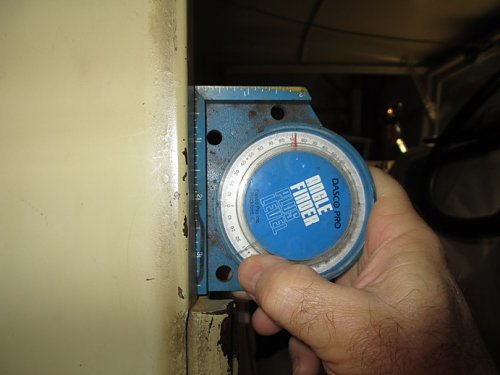

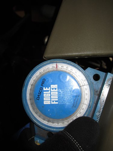

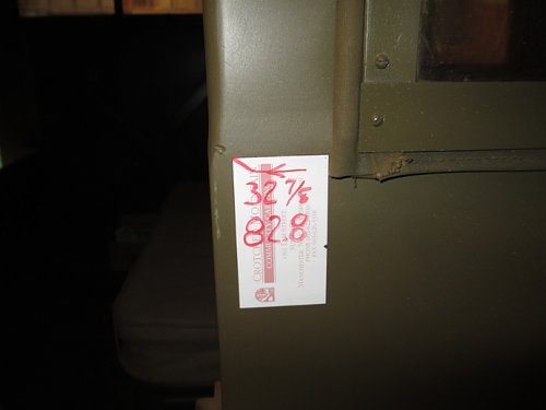

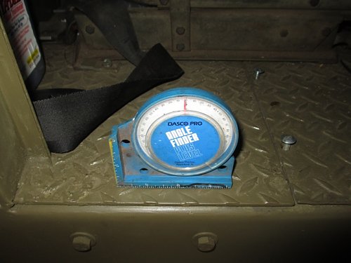

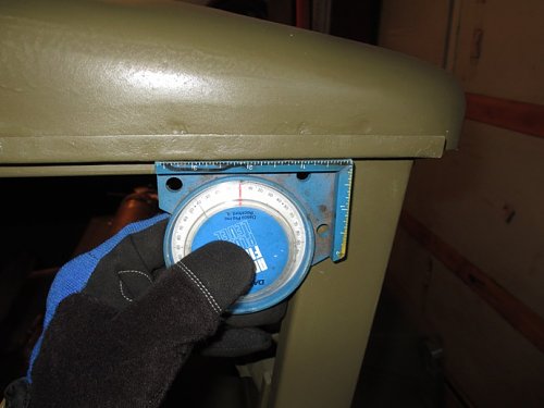

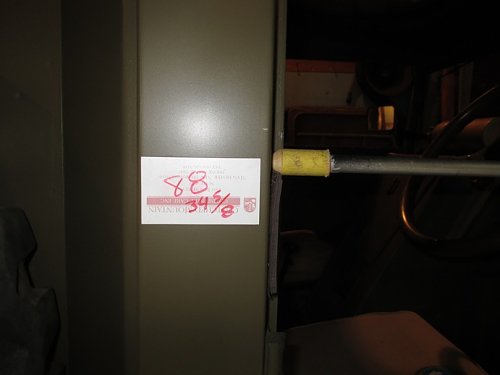

Default Started Angle Measurements
Hi Jerry

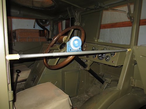

I started making Angle Measurements couple of samples below. They are not as readable as the should be so I'll work on the lighting so that not getting reflection off the scale. Also need to be sure picture is square to the needle.
Measured both my HUP and Pat 13 C60S and it looks like the angle of the windscreen is the same on both.
One thing I noted on the first pass through measuring and figuring out how to make measurements relative to true level. My shop floor is nearly dead level, but the HUP has a slight nose down angle.
The took some preliminary measurements on the front door openings on my HUP not surprisingly they are not identical +/- 1/8 inch.
Window Post Driver Side
Name:	WCMP HUP Angle Measurements 019.jpg

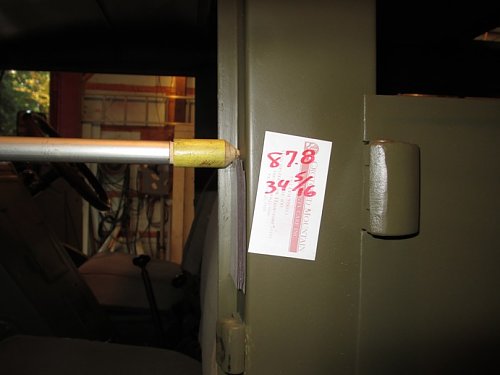

Door Post at Latch on C60S -
Name:	W CMP HUP Angle Measurements 003.jpg

Floor of HUP at Drivers Seat
Name:	CMP HUP Angle Measurements 012.jpg
Top of Window Post Roof Line
Name:	WCMP HUP Angle Measurements 030.jpg
Measuring across door opening
Name:	WCMP HUP Angle Measurements 040.jpg

Driver side front door opening
Name:	WCMP HUP Angle Measurements 042.jpg
Left side front door opening
Name:	WCMP HUP Angle Measurements 043.jpg
Left side passenger door opening
Name:	WCMP HUP Angle Measurements 058.jpg
Driver side front door post under dash
Name:	WCMP HUP Angle Measurements 017.jpg

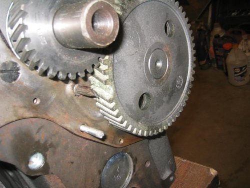

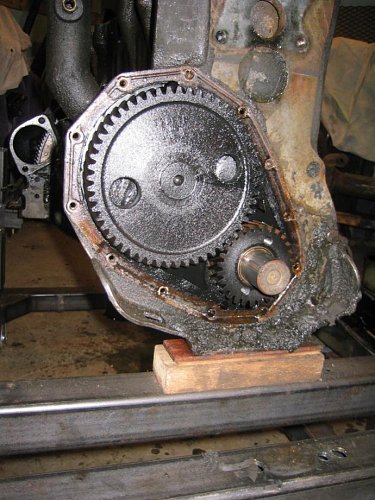

The dent in the timing case fouling the timing gear has been sorted along with the genny blades and miss-alignment. We just need to straighten out the fan blades and fit to complete the engine repairs. To remove the timing case it was necessary to drop the sump to get at the two bottom keep bolts, which fit thro' the front main bearing caps.
Jerry

If the timing gear has actually been touched by the cover, replacing the timing gear would be a wise investment. With the fibber timing gears it is very easy to break or crack a tooth. I've done it just bumping it while pushing the crankshaft gear on. If it is just a dent in the timing cover with no internal contact you should be OK. But you are wise to plan on pulling the cover.

I didn't study the cam gear, but it is black and stamped GM and looked like grey iron. Could I have been mistaken and was it fibre? The crankshaft gear is steel. If it is fibre, I think I should replace it as it made a light rubbing noise when I ran up the engine for 1 or 2 mins to test. Can you advise on a source. Rex Ward is v. good 'round these parts but his parts are focused on GMC & DUKW .

Here is what the original cam gear look like after 66 years of use in my HUP, looks like black metal but was actually fiber

Well, we've fitted the new fibre timing wheel - just in case the original was damaged, so the engine is complete and runs well bar fitment of the cooling fan.

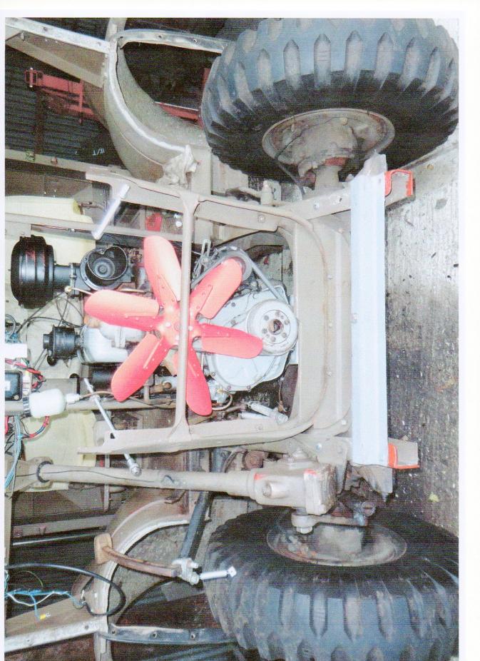

Our trip to the quarry early on Friday bore fruit. A nice straight fan and grill, plus a straight if grubby radiator. The photos show both sides of the banana shaped original and replacement. We'll use the original carrying frame which straightened out nicely.
I've trial fitted the bumper after straightening the passenger side frame damage. I took the opportunity to weld up a crack from a mounting hole. Both the bumper and nudge bar have an appointment with the 30 something ton Press. The nudge bar damage is easily seen. The bumper needs a tweak on both sides to correct action from the distant past.
The radiator carrier straightened out nicely and the front cross member aligns nicely, both are fitted. They will get bolted back properly after we've got the bumper and radiator back. The new fan has had a needle gunning and a coat of paint and scrubbed up nicely.
This week it'll be off to the radiator mender for a refurbish and a re-core, this will be costly. More corrective work on the front panel and split the doors to decide how we'll straighten them. Then it's re-align the A & B posts.
I'm trying to get as much done as possible before the weather gets grim and working outside becomes miserable. So far so good.
Jerry

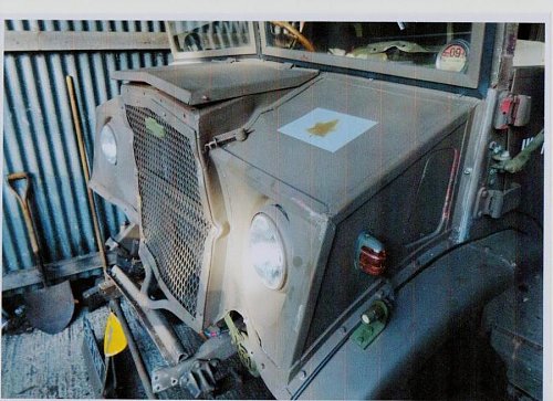

Yesterday I successfully pulled out the B post on the passenger's side, drilling at the point of contact right through the B post. On the rear door side the hole had to be opened up to 2.5 cm to get a nut and socket on the ring bolt and tighten it up. A cargo pull was attached to the A post bulkhead and the ring bolt then steadily pulled until all was lined up as it should be. The rear door shut is perfect. I'll have a go at the driver's side before the w/e, when I'll post some pics.
Pics today show the bonnet and frame completed ready for re-assembly, the passenger wing section with a replacement piece of zintec 2mm sheet ready for fitting. Likewise on the driver's side, which also has the headlight panel straightened out along with the straightened framework tacked ready for the next stage. The next pic shows the centre section of the front panel with the two verticals cut out. After some head scratching we decided the originals are too badly mangled to recover, so we pressed replacement 2mm zintec sheets to the same profile and over the coming weeks we will rework them to match the originals. The same can be said for the bottom section shown on the final pic, we cut off and straightened out the carrier that attaches the front panel to the chassis front cross member.
When we have remade these parts we'll drive the truck sans front panel about five drafty miles to the workshop for the first trial fitting/alignment checks of the various components that make up the front panel and make sure they align to the bulkhead before tacking them and welding up to complete the front panel.
Then there's the doors to be seen to and paint. Some way to go yet.
