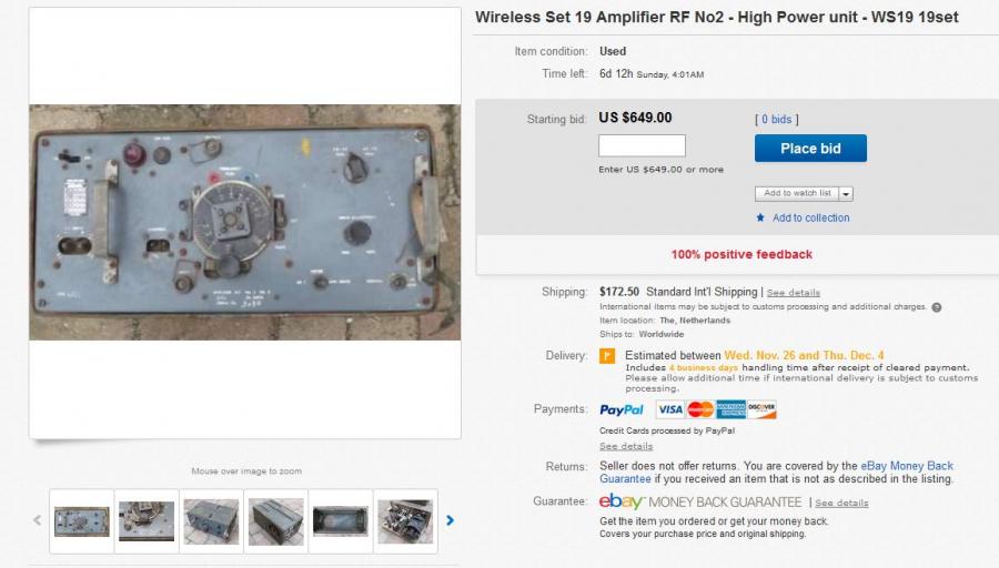

Here's a couple of 19 set items on ebay. I posted on the wireless forum because of the dummy aerial. Was it very common?
ebay HI power
http://www.ebay.com/itm/Aerial-Dummy...item43d2074053

Not that familiar with the British 19-Set HP. Is the chassis complete inside, or has somebody wogged some of the components? Looks like a few blank valve locations.
Also looks like quite a different design approach as compared to the Canadian HP equipment.
Old 11-11-14, 08:59
a Canuck/Brit in Blighty
Join Date: Jul 2004
Posts: 722
The set looks complete. This is the MK 2 version that used only two valves (tubes). The MK 1 version used 4 valves so that's why there are two blank holes. The power supply was integral. Overall it looks in nice shape.
It needs the proper power cable and special dogbone for the T/R switch. Whilst it doesn't use a variometer there is a large varable Aerial Tuning Inductance #1 used in the system.
While the Canadian high power amp was being debugged the army began using this amplifier. It soon became adopted as the standard amplifier and the Canadian HP amp was never deployed.
It didn't have the same power output as the WS19HP (Can) but was considerably lighter and didn't suck the batteries dry.
