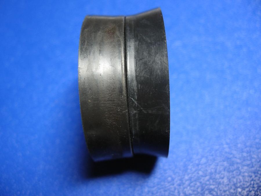

PBR don't manufacture imperial sized cups any more . They sold all of the dies/moulds to a guy who apparently destroyed them or sold them off-shore. You may get lucky and find a store with some old imperial PBR stock, if you do, buy them all . My neighbour has had problems with the IBS imperial aftermarket cups made in Spain , leaking -weeping in a AT4 dodge truck , they are narrower cups than the PBR ones . We did think of using two of them in series eg 4 to each cylinder . Mike

Default Spanish wheel cylinder cups
Hi Mike,
Thanks for that information regarding thinner Spanish made IBS cups. It made me go check my spares box.
Luckily the rear ones were the correct thickness NOS ABS items but the front were the Spanish IBS as pictured.
Even without measuring, the IBS cup on the right is noticeably thinner than an earlier original sample on the left.
Measured as best as possible on a rubber part: 0.350" vs 0.315" = 0.035"
Not a lot, but enough to cause problems with sealing obviously.
