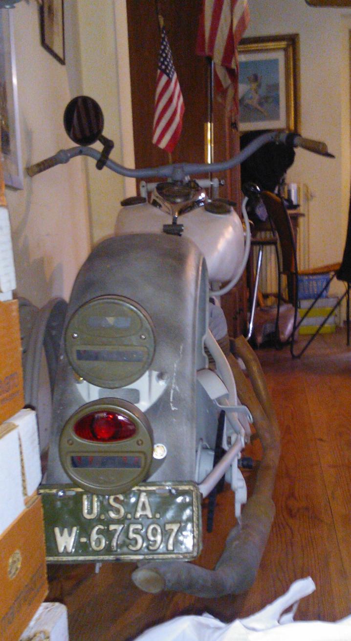

Hi Denis,
Great! wish I was that far, but have most of the missing parts now.
Please share more info, yours seems to be a truly Canadian one, as it has the duo passenger seat brackets.
ps, here's mine as it looks now;

Yours looks good so far! I love that tag. Looks original! I have a photo from the Indian factory of a bunch of military 640s in final prep and they all have tags. Many of us thought they were issued tags only once they had been sent to various units but the photo casts doubt on that.

My tag is 100% original, and for a 640 but not for my bike (Brit contract) but was the start of my search for a 640, as everybody has a WLA here in Holland!

When I got her home and fixed those things I went ahead and mounted the toolbox and mirror.
At this point, I feel like I'm practically an authority on Canadian Army 640s!
