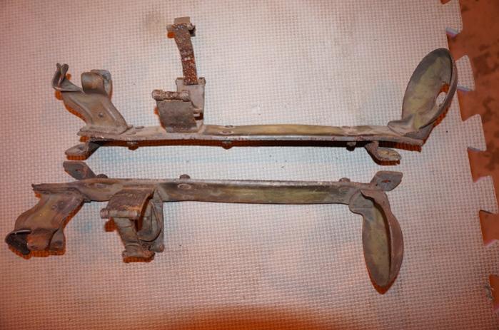

Here are some photos of two of the similar brackets. One has the extinguisher mount quite low, and one has it high. The screw holes in the back are different and match the brackets.
I have not taken these apart yet for sandblasting, but the high mounted one fits fine in the gunners position. Only problem is on the 2VP carrier I am working on, it is a mix of mk1 armour on a mk2 hull. I have to drill the hole through the angle iron yet for the bracket. Luckily it is through the armour (since the armour is mk1).
Thanks for the pictures Rob, Interesting on the differences in the 6 mounting holes between the two Extinguishers and the mounting brackets.

Here is what I can figure out so far with the latest picture from you and Rob:
1 There are 3 fire extinguishers in a MK1 carrier
2 There are 3 different brackets for the mounts
3 The gunners and rear deck mounts are the same, The driver side is different
4 The driver side and Gunner side bracket are the same dimensions BUT the 6 screw holes for the mount are different on each bracket as well as the gunners side uses 2, 5/16 holes to mount the bracket where as the driver side uses on 3/8 on top and a 5/16 hole on the bottom.
So one question remains is the bracket in the drawing I did and have seen in a few pictures a late model bracket or did some one just start making the bracket different to suit their needs as I have seen that bracket in the drivers and gunners area in most of the picture I have down loaded from this site ???????
