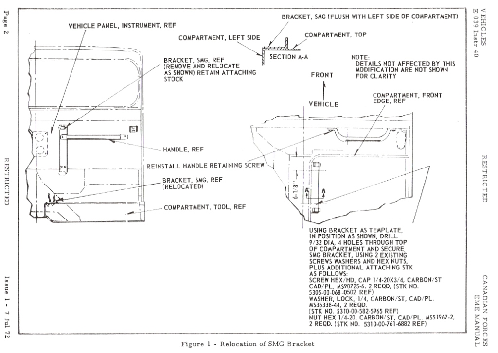

Did we ever determine the "proper" place to mount the 5 lb Ansul extinguisher in an M38AlCDN3?
I've used this Forum's search function but haven't come across any "final" answer.
There is a CFTO out on this but no-one seems to have a copy.
I've heard of various positions for the extinguisher, i.e. vertically on the dash, somewhere on the floor on the passenger side, horizontally behind the driver's seat, horizontally on the left rear sponson.
Some of the above positions don't lend themselves to the CDN3, whereas some of the positions might be suitable for other M38 production configurations.
Any one?
