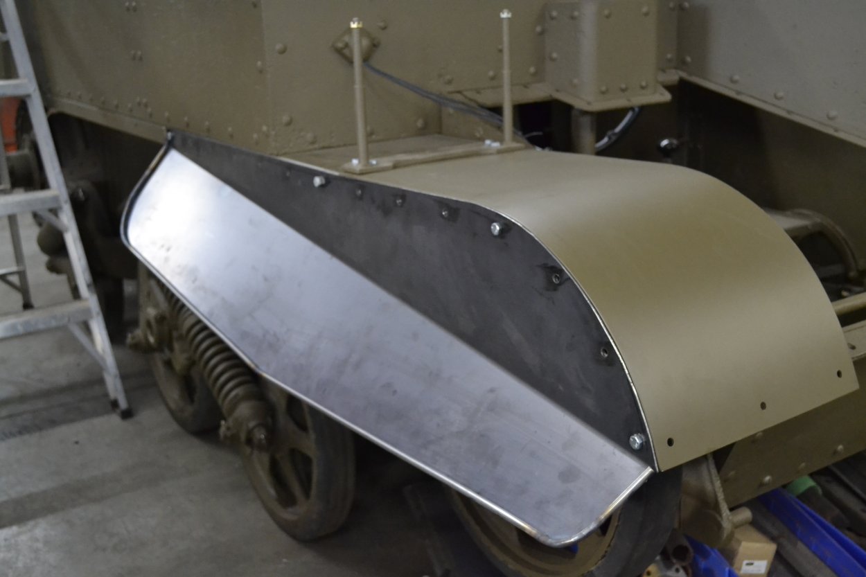

Well I just finished up fabricating new sand shields as the ones I got with the carrier were not that great of shape. Getting closer to getting another paint session in and then things will go a lot faster again
