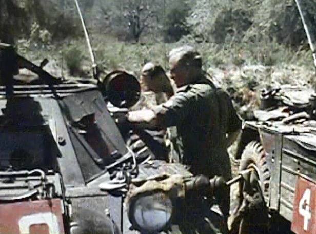

Here are some somewhat grainy images from Mike Jackson.
He shot 16mm at the time and has managed to capture some stills and they are reproduced here.
The interesting details I picked out were the ammo bin on rear right fender, not sure if it is bolted on but I somewhat suspect it is.
Then the telphone wire spool mounted on the side as er the modification instruction and another with one just hangin down front.
The Call sign placards are great, not seen those on Ferrets before in the CF. Wonder if that was a Meaford thing or just 8th Hussars thing?
Love the Ferrets loaded in the backs of the trucks, interesting it is not the smaller capacity deuce but the bigger American version with dual rears wheels
8Th Cdn Hussars Ferret call sign detail 02.jpg   8th cdn hussars Ferret Cal sign detail 03.jpg   8th Cdn hussars Ferret detail pic.jpg   8th Cdn Hussars Ferret.jpg

And loaded on trucks
8th Cdn Hussars Ferrets loaded on trucks.jpg   8th Cdn Hussars Ferret Loaded  on trucks.jpg

And one more

The trucks are mid 70s 5 ton M800 series with the Cummins 250 diesel. The old GMC M135 would not have safely carried a ferret as it would be pretty close or over the maximum highway capacity. Cross country capacity would be half of that.
They are not traditional call signs on the vehicles. There should be two numbers designating the squadron, then the troop, followed by a letter for the vehicle's position within the recce troop.

The call sign plates are unconventional. The presence of Ferrets in Meaford is unconventional. Do we know anything more about the occasion?

Great movie stills. Would also like to know more about the date the filming was done.

In post #2, second photo; the vehicle cab in the lower left corner appears to be an M135 (I could be wrong).

My first thought when M135 was mentioned was that the wheelhouses within the cargo box might be a nuisance. I agree that the cab in post 2 photo 2 might be M135. In post 2 photo 1, the cargo box might have the angle braces ahead and behind the wheelhouse that I associate with the M135 - not sure.

Besides the M813A1 5 ton, the other vehicle could have been a M211 as they had flat cargo floors. Either way, the Ferrets seem to be sitting on something as the wheels are higher then the floor levels of the two cargo bodies.

Grant, your observation of the cargo box in post #2 first photo is interesting. The Ferret in that box is sitting higher than the Ferret in the 5-ton behind it. Note the height of cargo box in relation to the axle-hub of the Ferret.

For a timeline I would guess at 1976 or 1977. There are what appears to be Chev 5/4 tons in the background along with a Dodge M152, so it was during the transition. And I think the 5 ton diesels were 1976 vintage, but I can't be sure. They might have been 1974....I'll have to check the EDR viewer.
It well could be that they put a ferret into a regular deuce with the wheelwells, and made the wooden spacers to fit above the wells. We used to do that for Jeeps, but a Jeep only weighs a third of what a ferret weighs. As I said before, you really are pushing the envelope with a ferret in the back of a deuce.

Great photos to compare the various cargo boxes Ed. The M135 box is least like any of the other truck boxes, including the M211. In the post #2 photo, it looks to me like the forward angled rib of the box (over the rear wheel) matches that of the M135.
I agree with Rob... if that is an M135, it has a big load on it's back.

Is that a piece of heavy armour in the background in that photo? Is it a Leo?

It is a Centurion, Canada did not get the Leopard until 1978.
Old 21-03-17, 03:02
I honestly couldn't tell which tank it was.If it were a Leo, then it would date the photo to 78, but it would be unlikely that a M152 and a Canadian Leo would be on the same ex.

The gent who took the photos says it was 1975 but as he is human like the rest of us he could be wrong, I will ask.
