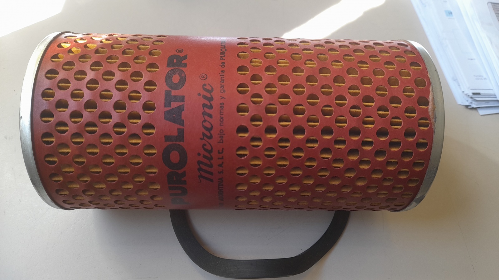

This is the replacement i found here in my contry.

Hi Mariano,
Good find. Just looking at the proportions of it I would guess that element is for the longer oil filter housing using two clamps to hold it.
