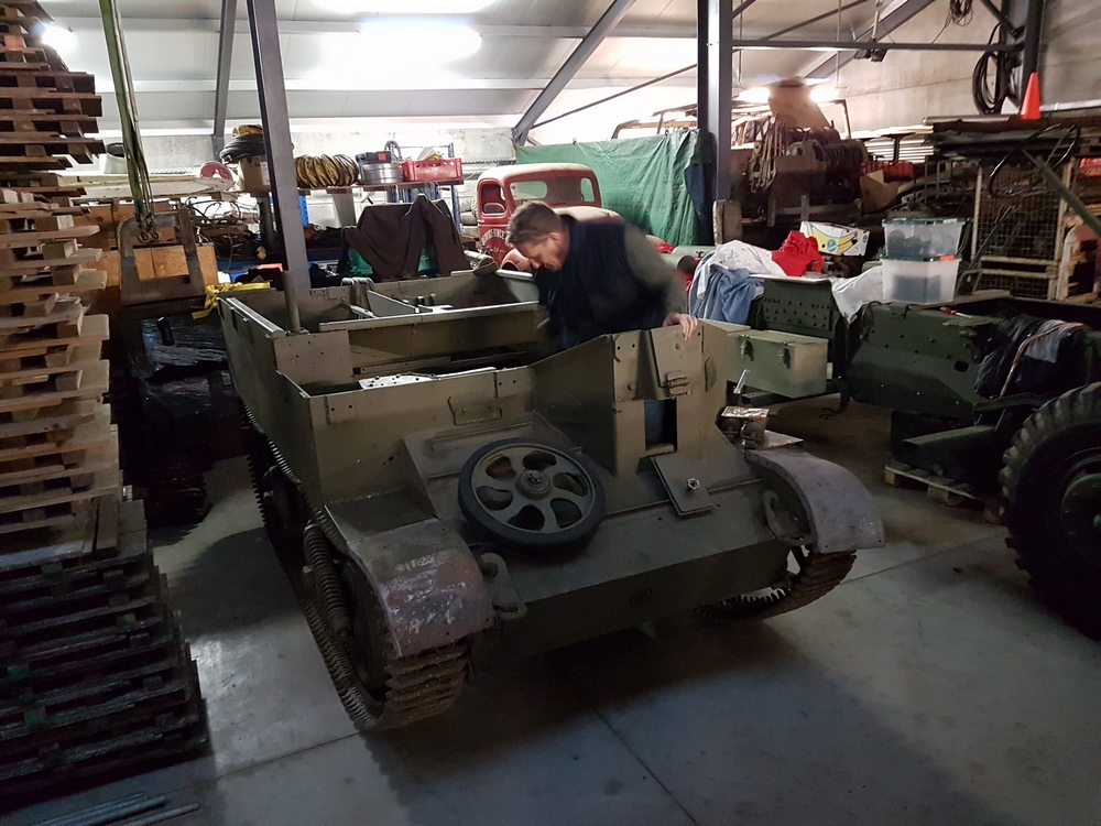

he finally arrived home
really in a good condition, it lacks some parts, but nothing to find I think
now beginning of the restoration
1 step: electricity
can someone tell me which number: T10 ....?, corresponds to the serial number: 10290

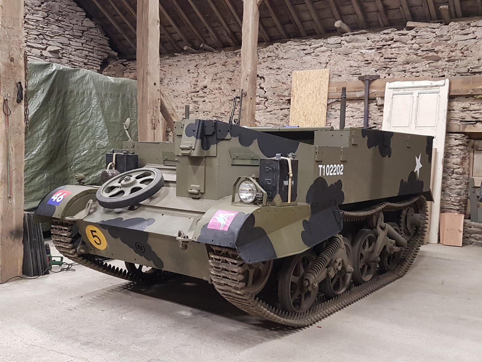

the T16 is finally finished
with his final markings: 114 Artillery Battalion, Platoon B, Belgian Piron Brigade 1944
+ test on road ok
