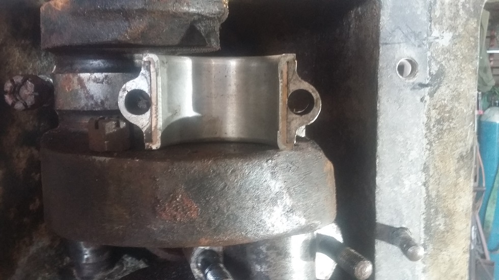

Thankyou all for your input. I have decided to go down the path of fabricating a new sump and riser. I think recasting would be very expensive and I feel quite confident in making the parts myself which I will do while the professional people do the head, block etc etc. On a good note however, I removed the oil pump from the crank case and pulled it apart. It is in great condition so I just cleaned the gears and blasted the housing and it will work like a new one which is not bad for 80 or so years old. The sump is 100% not useable as you can see and what you can't see is just as bad. At least I know what I have to do.

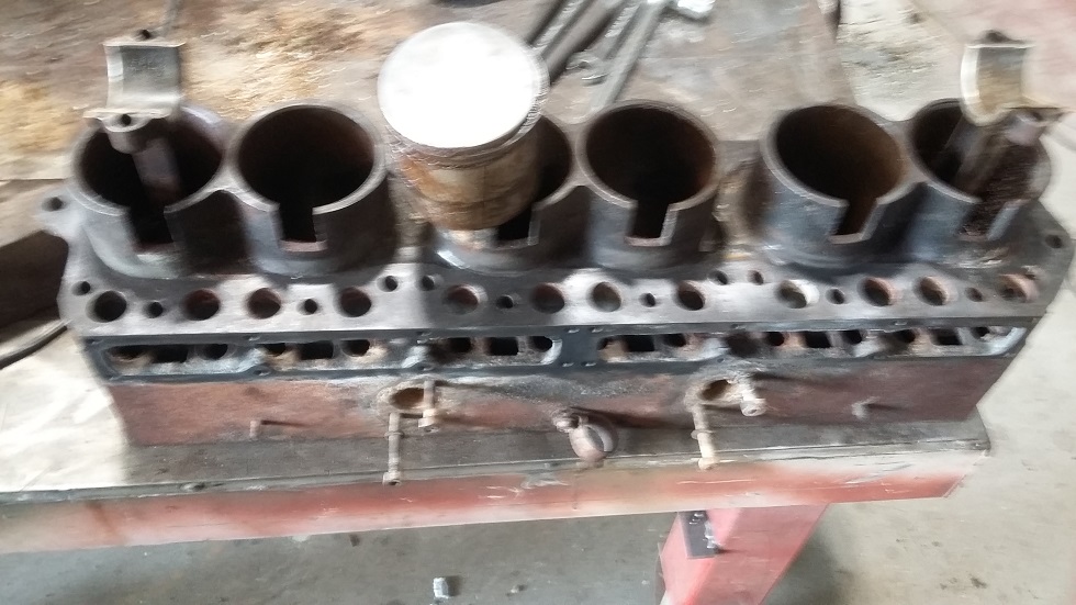

I managed to get the crankshaft out with no issues and it does look good and so does the block. I certainly does have sleeves so that is another thing in my favour.

I'm really happy that 4 of the 6 pistons came out without too much drama but the other two will take a bit more time. I cleaned the top of the pistons and they are all marked 1-6, dated 1936 and the military markings as well so they certainly are originals.
