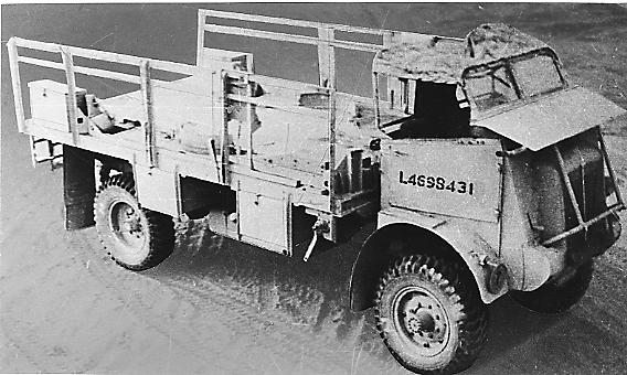

Default Official photo
Pre-rebuild!

Old 21-06-06, 12:39
Posts: 1,281
Hope i can help with this one as Portees is a favourite subject of mine in the form of collecting info and modelling
the QL photo offers a number in Davids contract details for CM4919
Ihope the rest will post OK as it is text info from a US model mag from i think the 1970s
