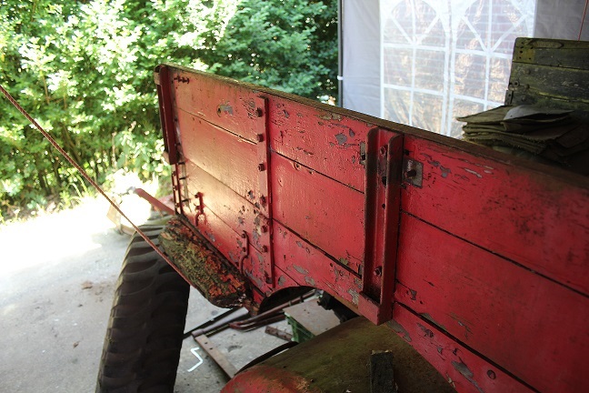

foto's of the 2A1 body...(remains)..
Chevrolet C15 Cab 11 2A1 body

Originally Posted by JohnG View Post
That is indeed the picture of a previous advertisement of the Chevy I bought. I had a expert with me who is restoring old cars (not military) and he had the impression that the restoration was done with great care.
Here are some more pictures I got from the previous owner. I think you bought a great project truck with much of the hard work done.
ID:	91710 Click image for larger version
ID:	91712 Click image for larger version
ID:	91713 Click image for larger version
