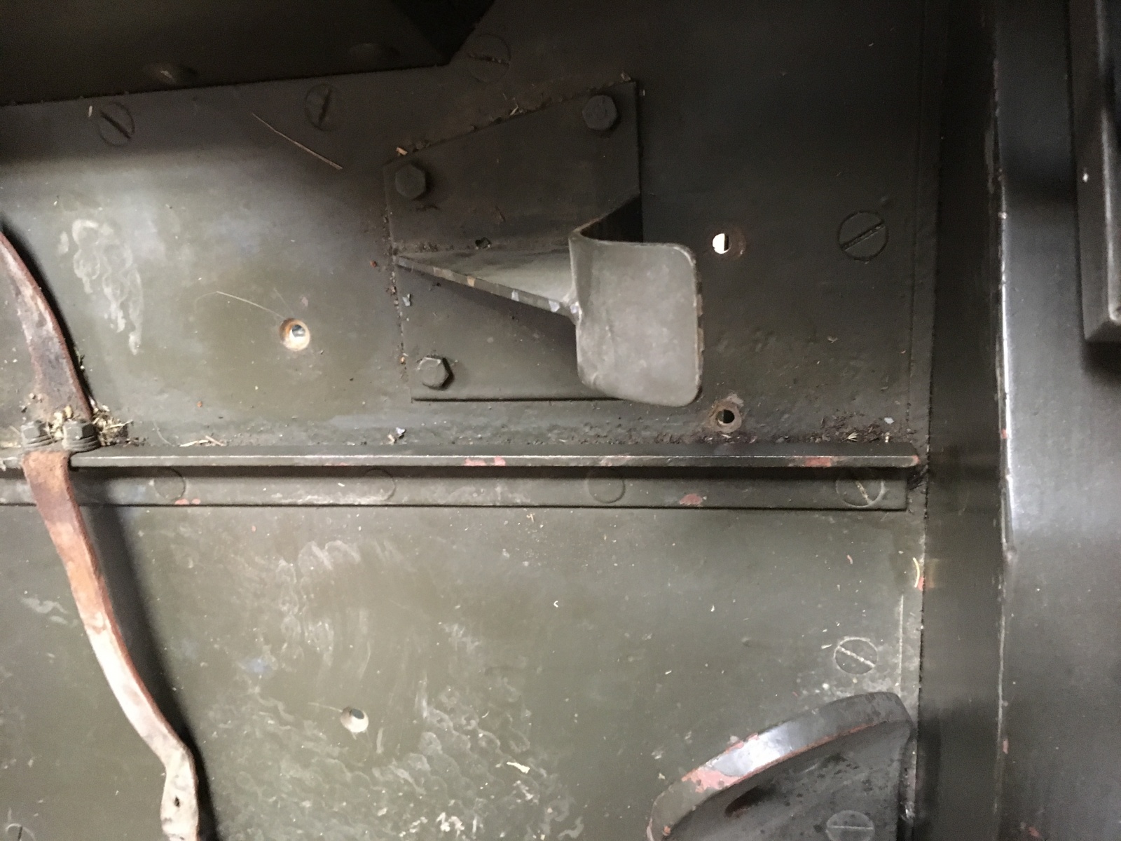

Found the four holes to screw in the bin under the glacis ! Petr it’s not the steel rope holder , it’s just beside it ! It took 3 hours this morning to find them and unscrew the rusted bolts .... Victory .

Again, another small interesting difference between british and canadians carriers. Slightly different layout of holes on mine. Anyway, you got the point.
This type of document bin is also used on Mk.II Mortar Carriers.
