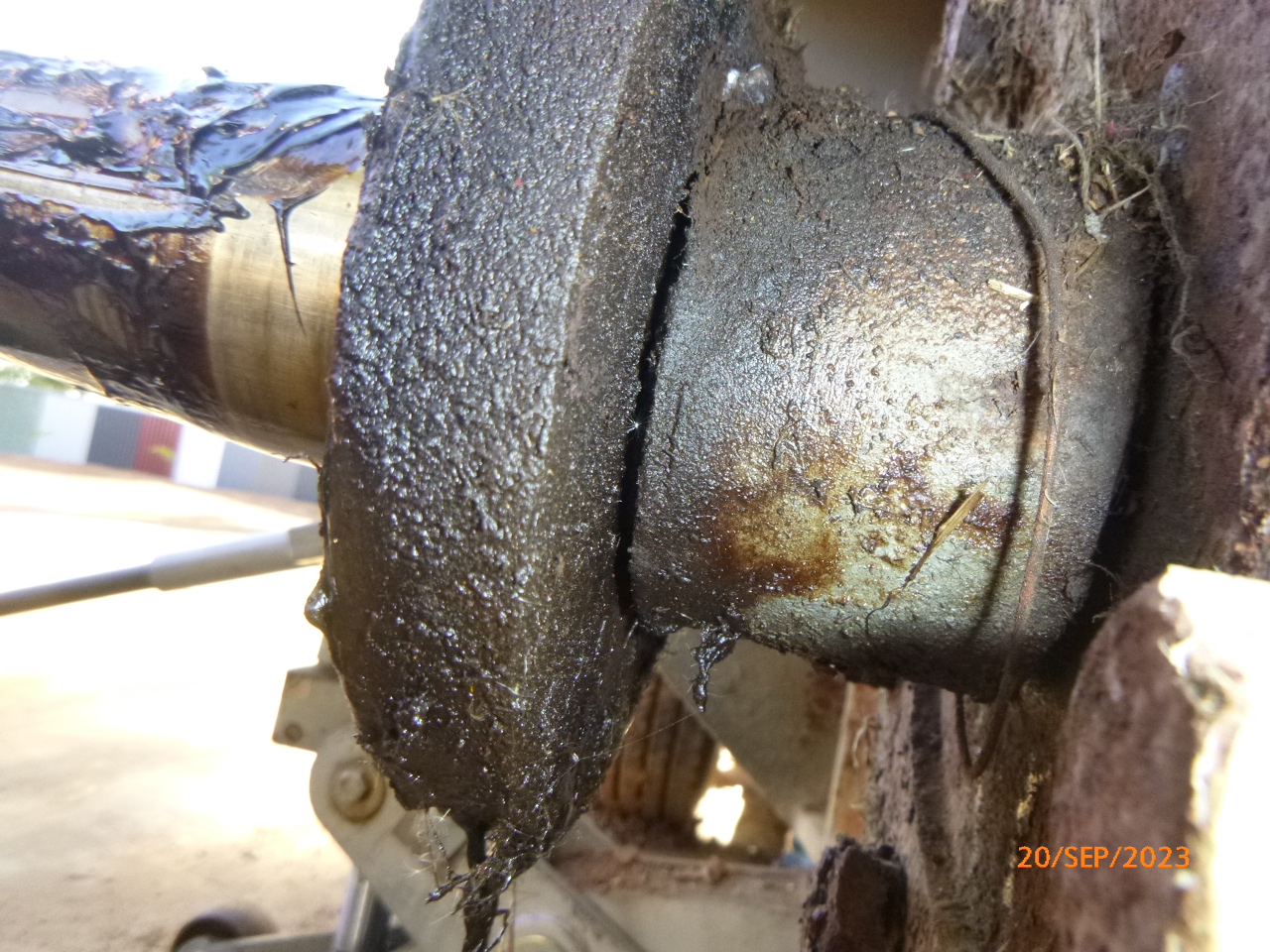

But the trailer has been grossly overloaded, and along with incorrect offset wheels, it has bent the 4 stub axles. One so badly that someone has removed the backing plate with all its' attachments with an oxy cutter. I need that lot.
Name:	LRT Bent axle problems 10 2019.JPG

The first job is to straighten the very bent stub axles mounted in the rear bogie rocker assembly. The bend can be seen here in the gap between the axle spacers.
Name:	LRT bent axle 10 2023.JPG
