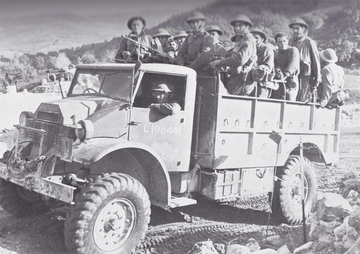

Guys,
I have just found a wartime photo I was looking for of the same vehicle rear body type, though I guess it might be a F60.
Its not particularly common. I was wondering if the preserved vehicle has a real serial number. The wartime one starts L1984.... so I guess L17.... etc is not too wild.
Details of the exact body style ref would be greatly appreciated
