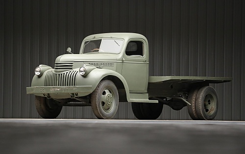

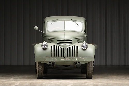

Hello Dave, good the hear you've added an MCP truck to The Ashby Stable Of Canadian Military Vehicles. Could you share some pictures? I'd be interested to see it.
From the thread Modified Conventional Pattern Trucks I learned:
1533x2 3-ton 134 1/2" w.b. with 9.00 x 16 wheels
1542x3 3-ton 160" w.b.
1543x2 3-ton 160" w.b. with dual performance axle and 20x6 wheels and single rears
There may well be more info here on this forum. The spare parts list for the 1542X3 seems to come up for sale every now and then.
I also find the GM Heritage's center's website very useful, see https://www.gmheritagecenter.com/gm-...tion-kits.html
And here is a "1941 Chevrolet 1543 GS (General Service) Truck" which was auctioned recently: https://worldwideauctioneers.com/lis...service-truck/. Its chassis number 4154278208 is on the data plate on the firewall, which incidentally lists it as a Model 1542. So the Chevrolet Model numbers are causing confusion.

Hanno,
Thanks for the info, that one pictured is identical to mine.
I too have a plate on the firewall which is remarkably close in numbers - I was hoping to find the chassis number stamped on the rail to verify the info on the plate.
To add to the confusion - doesn't the wooden steering wheel and military gauges make it later than 1941? Also engine number with first number being 4 denotes 1944?
Dave

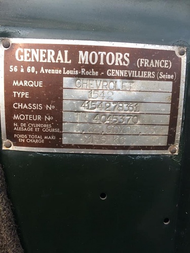

Info on my plate on the firewall has chassis number 4154278361 and engine number TR4045370.

On Canadian built GM trucks the first number of the serial number is the model year. That would make your truck a 1944 model. The year of the auction vehicle is also 1944 by the serial number, I don’t know why it would be listed as 1941.
GM Canada vehicles used this number system until about 1966. The later years used a system similar to the US format.

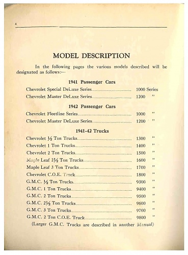

This scan was submitted by John Valenti.
It explains the 1500 series are 1941-1942 model 2-ton trucks.
Attachment 118223
Do we know the date of this document and wether it was superseded post 42?
Meaning if this document was produced in 42 the 1500 series would be 41 and 42, production of the 1500 series could have continued after but the info wouldn’t be on this particular document.
Dave

Good point, Dave.
There are factory photos out there of wartime CMP production lines and they were definitely not linear. You can see Cab 13 and earlier models all rolling down the line at the same time, so a lot of Cab 12’s will be out there dated younger than some Cab 13’s.
Documentation can be quite grey at times.
Dave
As I mentioned in my earlier post your truck is a 1944 model by the serial number and model 1542.

In a parallel thread on FB Dave posted a picture of the data plate on his truck.
It could well be the plate was fitted when it was rebuilt in France. Or more likely: when it was first assembled at an overseas GM facility from CKD kits.
David Hayward would have been able to explain it to us...

Posts: 2,323
Thank you for the photo of a data plate without the overpainting. It explains the line between engine number and gross weight that I hadn't understood - number of cylenders, bore, stroke (dimensions in mm).
Old 27-12-20, 00:58
Posts: 2,385
Interesting the two build plates shown have engines beginning with TR and only 24 apart: TR4045370 and TR4045394.
If Mike K is correct that the 'R' means a RHD build, then it is indeed strange that it would be built/assembled in France, which country uses LHD.
