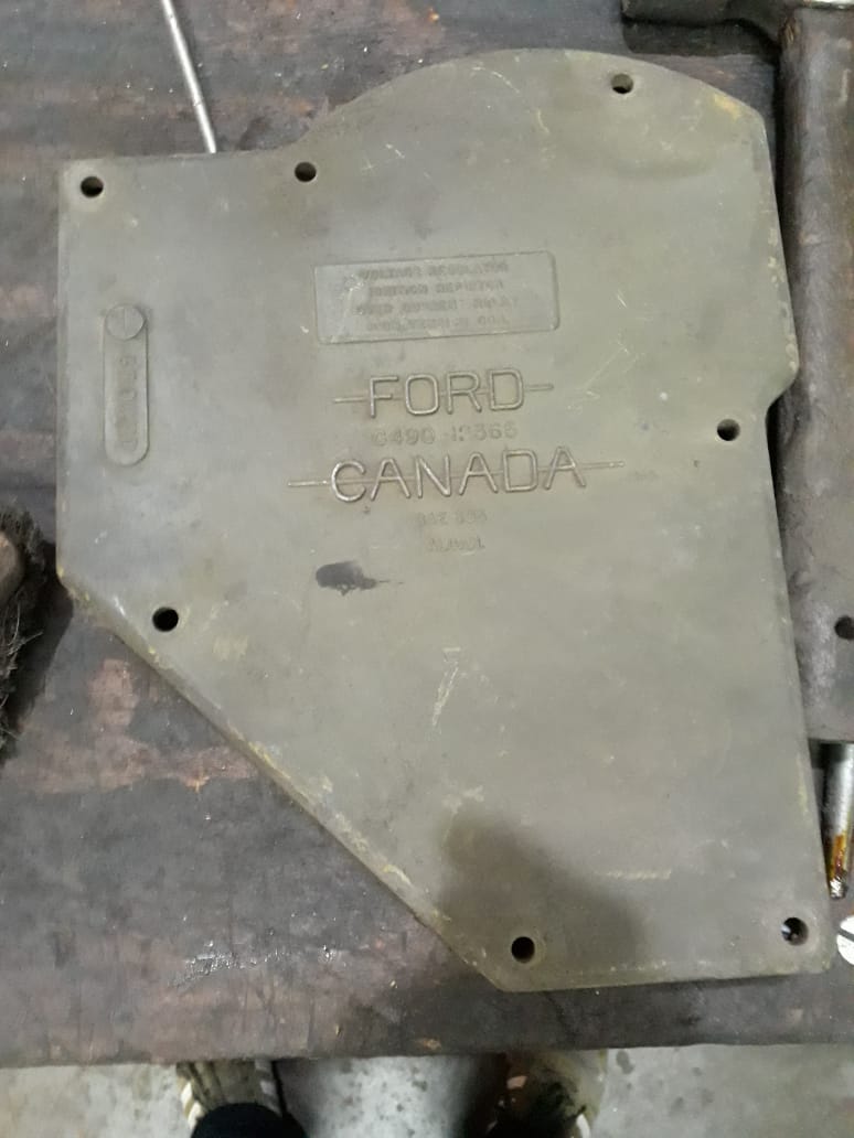

Another rare part found.... Aug 14 1945 the date.... listed on wiring and wadeproof diagram
