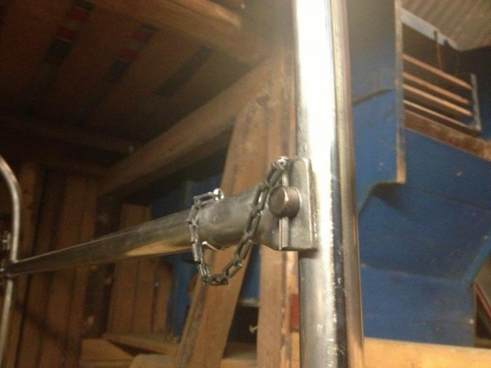

My top bows are done. Heres pictures of the result!
Svenn
Old 26-03-13, 02:56
Posts: 3,170
Default Woodworking
Nice metal work, now I see some heavy timber framing in the background of your workshop. What does the outside of the garage look like? Did you buy the building already constructed, or build it yourself? (You will make all the Australians jealous at the abundance of good sized trees and timbers.)

Yes Hanno by all accounts (99%) from pictures the 2B1 hasthe floppy bows with no horizontal bars like the cab 13, No happy with floppy bows!!!!
The curious thing about the centre ridge bars is that they are made of 3 pieces joined by thread and a simple union section.
The ex Jon S. cab 13 that is now owned by Gary in Kingston has what I believe is original bows/pipes and original dated 1943 tarp and will get measurements from him soon.
Are the hooks that you showed onMLU from a 2C1 or a early 2B1
Will take some pictures of my box rebuild progress today.

The nearest modern equivalent pipe to the ones described by Bob above is 3/4" nominal schedule 40 pipe. The differences in dimension (both OD and wall thickness) are less than 0.010" - close enough that I think it can be called a match.
One interesting observation - the pipes are made in three parts, two shorter at the ends and a longer in the middle, joined by threaded couplers. The ends of the couplers appear to be more rounded than modern equivalents, possibly a modification to make them less hard on the tarp? The construction of the pipe is such that I think it would have always been either fully installed or fully removed. I don't see how it could easily have been set up to allow only two of the three bows on a 15cwt box to be used as would have been possible with the shorter piles pictured above. Also, unlike the pipes shown above that mount to pins, these pipes seem to have been made to be fitted with carriage bolts (remnants of square holes). The ends of the pipes are slightly curved in the flattened section to wrap around the upright and reduce wear on the tarp. The sample pipes are also too long to fit the uprights of a 2B1 box.
However, most of these features (mounting style, single, full length pipe and longer overall length appear consistent with the body for a 8 cwt, which is what David Moore had.

I also found a refence to top bows for the 2B1 box: there were two types, the second one had the vertical tie bars as on the later 2C1 and upwards bodies.
Not sure what you have there Bob, show us some pictures ;-)
But the 15-cwt top bows were made from a single piece of tube, so no threaded joins with union section. CMPs were not designed to go in a sea can as they had not been invented yet - sorry Bob, but you will have to take off your top bows every time you store the truck. Or discard originality and copy the system on the 3-ton truck where the bows could be set in a high or low position.
The hooks showed in post #13 are on my truck's 2C1 body.
