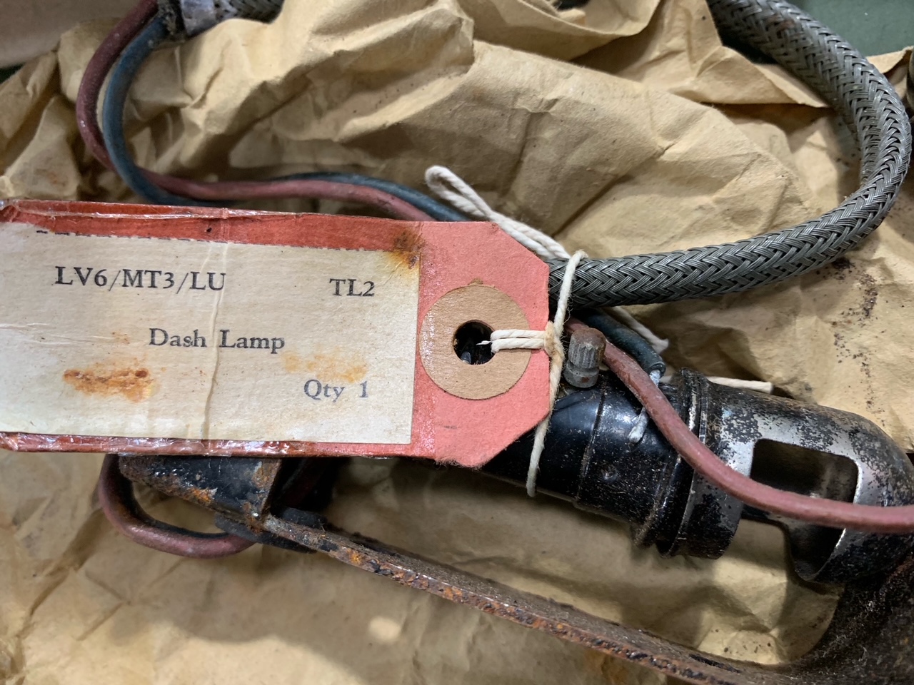

Default Dash lamps
Got a couple of dash lamps, Canadian and British.
hey Kevin: that lamp with the single wire looks quite similar to the vintage civilian vehicle lamp produced by Cole Hersee. A nice substitute for the military issue?
Old 14-10-21, 16:41
Posts: 567
Michael,
That Cole Hersee lamp looks exactly like the interior lamps in production Ram tanks. I used to have some. I have no doubt that the Canadian carrier part was the same. Well done for spotting the origin.
Old 14-10-21, 17:31
Posts: 4,189
Just be aware that Cnd carrier dash lamps used two wires.
Old 14-10-21, 18:05
kevin powles's Avatar
kevin powles kevin powles is online now
Join Date: May 2006
Location: united kingdom
Posts: 2,002
Yes, but makes a good substitute if you can’t find the original ones, got three here new in the box
