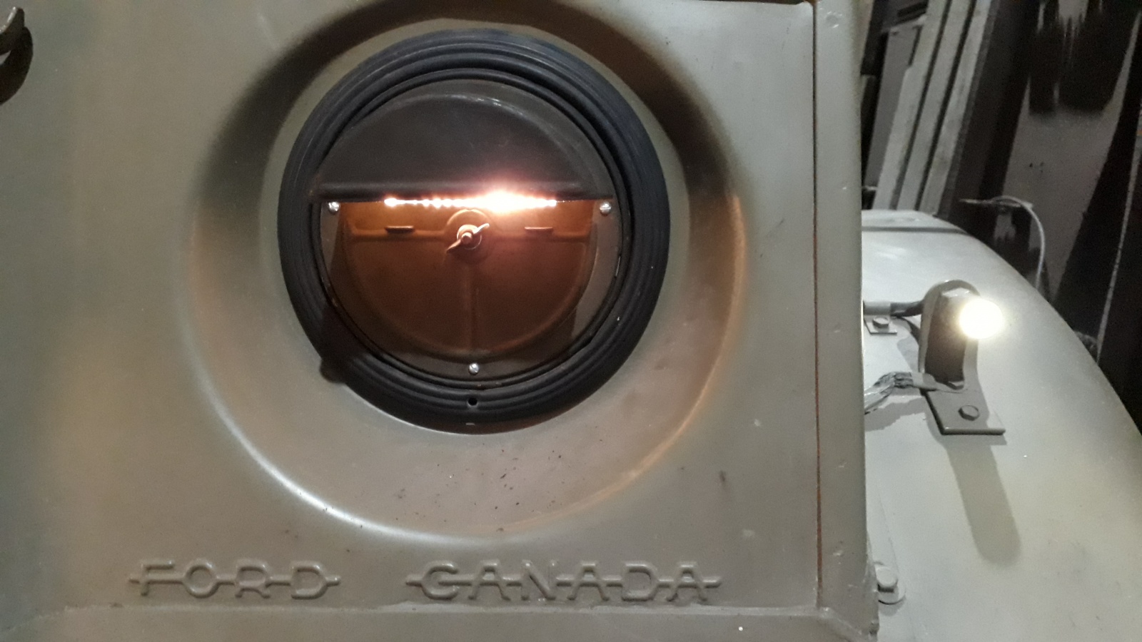

The glass lens is the remains of the late WW2 blackout shield that allowed for both blackout and headlight use with a rotating half-circle. Very useful for modern use. The other shield is the standard early shield. I have both styles available.

Based on your photo, Brian, the lens in Marty’s truck needs to be rotated 180 degrees to get the headlamp portion to the bottom of the assembly and the more diffuse blackout portion to the top.

David: Yes the glass on Marty's truck is mounted upside-down.

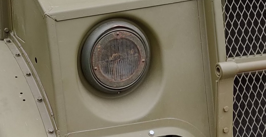

Default Unknown headlight
This headlight surfaced when a C15A was recovered by Morten Grorud in Norway recently.
Can anyone ID it? It was suggested this is a Ford light.

This looks like a lens for the late style dual purpose blackout/driving light.
The blackout shield that's supposed to be on there has a rotatable piece to block light if blackout driving is required.
See: Lens Identification

Thanks Marty. So the light still has part of a blackout shield attached? The broad rim is what confused me.
It does look like that is the case. I do not own the shield itself, so I don't know how many parts it has, and how many parts are missing on mine and the one pictured in your first post.

Interesting! So it looks like that the outer ring could be swapped for the blackout shield instead of adding the shield on top.

Default Headlamp
Thanks Mariano, that solves the riddle!
I am see "broad rim" nr. 13061 which secures the glass nr. 13063 sits under the bezel nr. 33003-S. Rim nr. 13061 can be swapped out for blackout hood nr. 13063.
Two assemblies (C49Q-13060 and -13002) were supplied to enable an easy swap in the field.
