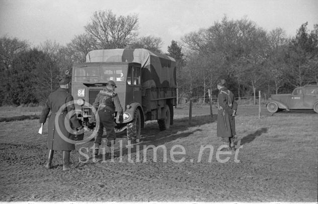

Not sure what this is and the vehicle behind..anyone please?
L 209113, with Armoured Division? RHINO, and "84" so it's a Thornycroft 3-ton 4x2 from the batch L 208495-209284

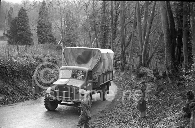

Default Commer?
I think that's what it is

Hi David
first one is a Thornycroft WZ/TC4 3 ton 4x2 GS and i am sure the car in the background is a Humber with an unusual rear body conversion the second definatly a commer Q4 3 tonner
cheers
Les
Old 05-12-07, 21:03
David,
The first photo, in the background, could be a Hillman 10hp van. Second photo is a Commer 3 tonner.

RASC Lorry Driver Trials! Here's another shot with an interesting staff car.

Old 05-12-07, 22:23
Default Re: Cheers!
Doohhh
That is the vehicle in the background of first photo. Should have recognised it as I am restoring one It is a Humber Snipe, the roof rack made it look like a higher roof line to the rear, hence why I said van originally.

Default Commer
My friends Higgins Commer

Old 07-12-07, 10:42
Great picture Radek,
By the way, has anyone got an idea hom much Commer Q2's and Q4's are still surviving? I have seen one Q2 before, based in the UK and the one Radek showed. Any 3 tonners surviving?

Wink Commer
I have seen one in Australian bush, pictures was in the past on MLU. I will contact Higgins, he has any contacts on owners. I thing is is only a few.
He made on his Commer great work, the lorry was safe from scrap.

Old 05-02-08, 13:12
David_Hayward (RIP)'s Avatar
former Resident Historian
Posts: 3,841
Default Rhino badge
Am I right in thinking that the Rhino badge indicates the 1st Armoured Division please?

Old 05-02-08, 13:48
PPS PPS is offline
Paul
Location: Limavady, Co. Londonderry, Northern Ireland
Posts: 346
A newer version of 1st Armoured Div Badge shows a white Rhino facing right in a black upright triangle with a red border.
http://www.army.mod.uk/royalsignals/1adsr/index.htm
Wiki shows the same badge.
Paul.

Default Numbers
I am debating what these numbers, 81, 82, 84, 87 are...are they in the convoy slots? They could be team numbers. Note headlamps covered over...it seems that each lorry had a number written on a cover.
Old 06-02-08, 11:21
Posts: 3,841
Default And another
OY having wheel changed. In full kit?
Old 06-02-08, 22:10
David,
The numbers you are asking about, are Unit Serial Numbers, for RASC Companies. Although the OY driving up the hill has the sign on the wrong side, the one having its wheel changed is in correct location and you can see the number is painted over a two coloured square. This would be red over green diagonally split, which is the colours for Royal Army Service Corps.
Old 06-02-08, 22:54
Posts: 3,841
Default Ta!
Thanks Richard.
Old 06-02-08, 23:32
Red face Unit signs
David,
I made a mistake on my last message, re. position of signs, the OY coming up the hill has the sign on drivers side, which is correct, the Divisional sign would be on passenger side. The OY having its wheel changed, has the sign on the passenger side, but it may be on a Pass plate, which was an early fitment, whereby if a vehicle had broken down and was waiting assistance to arrive, the plate was reversed in its holder to show the word "PASS", so that other traffic knew that the vehicle did not require help. Now I have a feeling the Pass plate holder was on the nearside. They were discontinued early in the War, judging by photo evidence.
