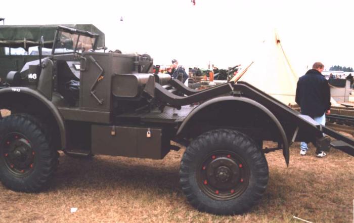

This is a Canadian Military Pattern vehicle, built by Chevrolet, a brand of General Motors Canada. Based on the Chevrolet Gun Tractor (CGT) 101" wb chassis, a small number was built as a 2-pdr AT Gun Portee. They were fitted with the second model cab, the No.12, placing it in the ca. 1941 timeframe. Pic below shows what they looked like after assembly in the UK. Full story in one of the back issues of Wheels & Tracks magazine; more pics and info over on the Maple Leaf Up Forum.

If this vehicle is in the UK, it is probably scarce, as most of the UK Portees were converted to tow vehicles for the 17pdr Anti-Tank gun, or to GS vehicles.
The body remaining on the ground in front of the truck appears to be (without the crane) the remains of the original portee bodywork (eg the small hand driven winch, the hinges on top of the guards), indicating this vehicle wasn't converted to GS spec.

I agree, also look at the fuel tanks mounted to the back of the cab.
