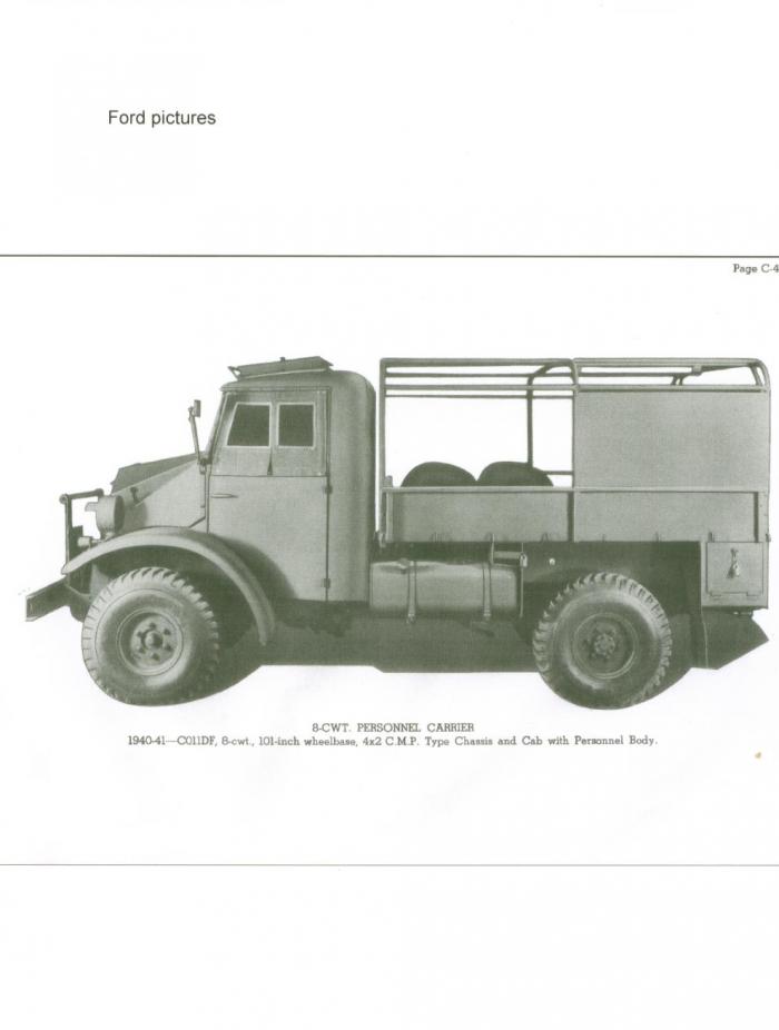

Default Picture of tool stowage
Terry Creighton in NZ has sent me lovely factory pictures of the F8 long box showing where the pioneer tools were stowed - see attached pic - hope it comes out clearly after scanning. Note the sheet metal on the LHS attached to the tilt hoops. Clip for axe and shovel - and holders for two Lee-Enfields. The extra piece of sheet metal in the roof holds the rifle for the third rear crew member - three seats provided.
I also can just see a rear view mirror inside the cab. Also note that there is only one rear light each side (one brake, one running?) but a double lamp holder each side?
Thanks Terry
I'll put the side view on the next post.

Here's the side view of the long box F8
