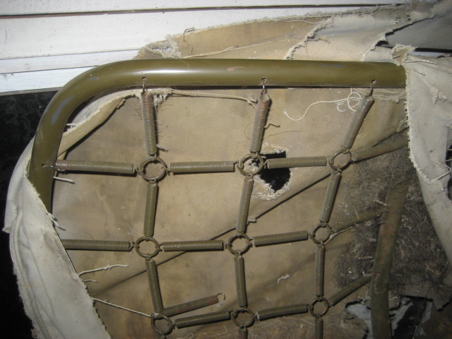

I am glad you brought up the subject of paint for CMP's as I will need to find a source and a proper color to paint my Ford CMP ambulance and all I have to go on as far as an original color is the seat frames.The covers protected the paint from fading and looks like a semi gloss green?On the inside storage compartment of the ambulance box seems to be the same color.Is this proper for a CMP to be painted for a 1944 production.If it is,the best thing for me to do is bring in the seat frame to the paint shop and have them scan and mix the paint from the seat sample or is there a company in Winnipeg I can go to that has the proper code recorded I can go to?Thanks,

I am no expert on paint and can only give you my opinion. My request for matches outlines my desire to learn more. With regards to your seat frames, what a great example of what appears to be original paint. I have noticed in other shots that pics on the web don't always reflect the actual color under natural light. Same goes for taking pics under flouresent light. All the same you seen to have an nice example in which to get a color match. Best of luck on your journey....

Derk, the sample on your seat frame was originally matt but is semi-gloss because it has been polished by the seat cover all these years. Original CMP paint is matt-matt-matt. I know a lot of restorers use semi-gloss because it stands up better than matt. Another tip while painting your CMP is to leave lots of drips and runs. That too is origin...
As to the colour, Mike is right, it's hard to tell from a digital photo. For what it's worth, it appears to be 'khaki'. A 1944 CMP 'should' be 'Canadian' olive drab (Not, US O.D. Mike is matching the Canadian colour as we speak). I've had three or four 1944 Chevs that clearly were 'Khaki No.3' which by the book shouldn't be. Another thing to consider is that not all the part on a CMP were necessarily the same colour. Parts like seats, running boards, etc. were often assembled in the factory from a stockpile of the 'old colour' parts, or added later to the truck.

Bruce,
I was wondering the same thing,if the seat cover rubbed the paint to give it a glossy look.When I took off the front fender,a square of original paint was still there and it seemed the same color but definitely a matt finish to it.I will now use the fender paint sample to match the paint,unless Mike can find in his search a proper paint code to use.It is going to be cold here for awhile and won't be painting anything for months yet so I have time to find a proper shade to use.I am glad it turned out to be matt paint as I like that look better on an army vehicle.My problem is it will have to be stored outside for the next few years until I can afford to build a garage to store my vehicles in and would want a durable paint that won't sun fade bad.If I tarp it,the wind will rub the paint in certain spots and either polish or remove the paint.Any suggestions on what brand of paint is the most durable to use?Oh and don't worry about runs in the paint,that's a guarantee when I paint!
