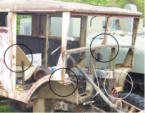

Hi Rob...The 2nd photo shows the issue I have with the crack to be repaired should be easy once the body is off the truck. Plan too cut the crack lines open and drill a hole just beyond the end of the long crack should then be able to weld the crack cuts tight. Cheers Phil
Phil, My 45 had the same crack in the same location. I also found a number of cracks on the frame - see attached photo - that you may want to check out on your HUP. Keep in mind that my HUP was very much abused...
The white circle was to remind me of the cracked "sled" or runner on the pax side of the truck. The other points included the lower central windshield frame, the point where the upright post meets the wheel well and the door frame just above the guideway. My poor truck was wracked, bent, twisted, torqued and overstressed in so many areas. Thus, the cracks.
RHC

Default Crack locations
Hi Rob
Thanks for pointing out other problem crack locations, I'll be sure to document all the problem areas I find.
My HUP had a strange crack in the middle of the roof in the forward area I think caused by the heavy forward hatch ring bouncing up and down.
The center post of the my windshield is bolted not welded. Had to replace the bolt at one point because it worked loose and then broke when I tried to tighten it.
Redoing some of my early body work may be difficult as I brazed several sheet metal cracks on the fenders back in the 80s. Now either have to cut cracks and brass out and then re-weld or get the equipment to braze again.
My HUP has had a hard life too, of lots of off road use, and I'm glad to say I had all the fun of driving it over all that rough terrain. Other than cross slope there are very few places a MB, M38, M151 can go that a HUP can not follow, Jeeps charge hills and bounce over obstacles HUPs just slow down and crawl over them.

...The center post of the my windshield is bolted not welded. Had to replace the bolt at one point because it worked loose and then broke when I tried to tighten it...Cheers Phil
My vertical/center post is bolted as well. The horizontal bar beneath the center post was split from a frontal impact. I can only imagine it was quite a hit...

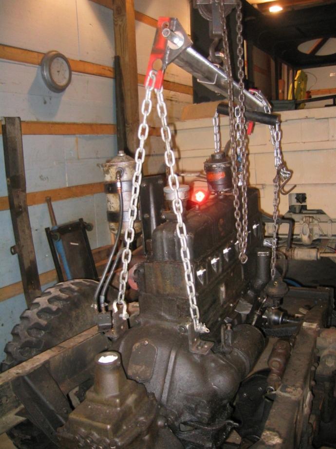

Hi All
Today pulled the engine out of the chassis, must say it is a lot easier pulling the engine out of chassis rather than out with the body in place. But only easier if you have to body of for another reason.
Pictures below show the process, the engine balance rig is one I made specifically for pulling engine out of CMPs. When pulling engine with the body in place you need to remove the valve cover and position the balance bar down just clear of the valve train. The attachment points are the bolts holes on the top of the bell housing and down on the sides of the front engine mount. This makes the chains clear everything.
Engine is now sitting on an engine stand so that it can be cleaned, tested and moved around easily.
copy 2-8 Beast Rebuild Camera 008.jpg   copy 2-8 Beast Rebuild Camera 009.jpg   copy 2-8 Beast Rebuild Camera 019.jpg   copyBeast Rebuild 2-8 GC 049.jpg   copyBeast Rebuild 2-8 GC 051.jpg

When we last left our story the poor BEAST the chassis was lounging around the barn in the nude, stripped of most of its parts. (pict) Now it axles and spring assemblies have been removed. Axle housing are all cleaned sanded and ready for paint, more on that in a moment.
With everything that can be unbolted from the chassis removed the frame is really pretty easy to handle (pict ) shows the frame hanging from its CG with the ratchet strap only keeping it from doing a titer totter act. The chain fall holding this is the same one I use for engine pulls and is rated at 500-700 lbs. I make note of the CG locations of the heavier components as it makes handling them alone much easier. Once you know where the CG is pretty easy to flip the frame over or stand it on edge to work on it. (pict)
Which is heavier on a HUP the individual axle assemblies or the engine transmission group? Answer the axle assembly by a large margin. To pick up either front or rear axle assemblies with the chain fall had to remove tires and brake drums. With out lightening them all I was doing was climbing the chain.
Once it axles can be lifted I hung them from the chain fall supporting some of the weight on sawhorse to clean and get them ready for paint. (pict)
Getting to the correct OD color is the next step I’ve been taking photos of various protected locations on the HUP during the dis-assembly places where dirt, air, and light has left it alone places such as tight fitting body parts, under mud flaps etc. These I’m trying to match up with OD paint colors and spec numbers that the local paint store can mix. (pict) this picture is rather small and may loose something in the smaller size for MLU, so I’ll post it at a higher resolution on my web site this week end.
Progress has slowed now that I’ve gotten to the real mechanical parts because I changed over to clean parts as I work instead of just disassembling everything then starting to clean. Without really cleaning stuff I can see what needs to be replaced or reworked.
Stay tuned for more of the saga of three CMPs living in the woods of New Hampshire.
