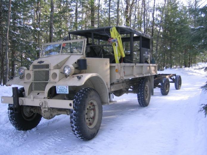

Between snow storms I finally towed the HUP down to the heavy truck shop this morning. Had to be there at 8 AM as they proprietor had to go out with his back hoe and finish cleaning up the latest storm before the next storm tomorrow. Being a one man operation he wears several hats including doing a plow route for the town.
So it was a bit nippy heading out with the temperature down at -11 C but not a long trip about 3 miles. Whole trip in 4 wheel drive as the military tires on the nice smoothly plowed roads needed the extra traction. In all it actually took longer to pull the HUP out of my shop and get it back into my shop than the rest of the process. Hour and eleven minutes from the time I arrived at his shop till I was driving away with the body in the back of the C60L.
First step will be to remove the engine so I can put in on the engine test stand and do some run tests to figure out what work is needed (more on the test when I start on them) anyway I want to determine early on if it is going to need any major machine shop work as there generally is about a 2 week wait on that stuff.
Now I can really get started on the work and in particular where the paint is needed the chassis and the underside of the body
Here are some pictures of the fun.

Haven't really decided how I'm going to work on the body yet. Considering a couple of options all depending on progress I make on the chassis, engine and the weather. If spring comes before the chassis is done I may take the body down to a local stone cutter/antique car restorer and have the body sand blasted.
I like this guy for this type of work as he has about 12 antique cars and knows how to clean paint off without damaging the metal. His primary business is as a monument engraver which is mostly done by sand blasting now.
What is kind of interesting about this guy is he learned his trade from his father who was a German stone mason, who emigrated to the US after being interned here in the States as a prisoner of war. Having been captured in North Africa, as a member of the Africa Corp. I met his father some 30 years ago when he came over to look at the HUP at one of the first shows I took it to. His father said he had seen a few of them before, as we talked it came out where.
If winter last two long I may turn the body on its side on the cargo body using the the trucks hydraulic arm and the chain hoist in the shop bay. If I can figure out the mid-line CG this might be the most practical.

When we last left our story the poor BEAST the chassis was lounging around the barn in the nude, stripped of most of its parts. (pict) Now it axles and spring assemblies have been removed. Axle housing are all cleaned sanded and ready for paint, more on that in a moment.
With everything that can be unbolted from the chassis removed the frame is really pretty easy to handle (pict ) shows the frame hanging from its CG with the ratchet strap only keeping it from doing a titer totter act. The chain fall holding this is the same one I use for engine pulls and is rated at 500-700 lbs. I make note of the CG locations of the heavier components as it makes handling them alone much easier. Once you know where the CG is pretty easy to flip the frame over or stand it on edge to work on it. (pict)
Which is heavier on a HUP the individual axle assemblies or the engine transmission group? Answer the axle assembly by a large margin. To pick up either front or rear axle assemblies with the chain fall had to remove tires and brake drums. With out lightening them all I was doing was climbing the chain.
Once it axles can be lifted I hung them from the chain fall supporting some of the weight on sawhorse to clean and get them ready for paint. (pict)
Getting to the correct OD color is the next step I’ve been taking photos of various protected locations on the HUP during the dis-assembly places where dirt, air, and light has left it alone places such as tight fitting body parts, under mud flaps etc. These I’m trying to match up with OD paint colors and spec numbers that the local paint store can mix. (pict) this picture is rather small and may loose something in the smaller size for MLU, so I’ll post it at a higher resolution on my web site this week end.
Progress has slowed now that I’ve gotten to the real mechanical parts because I changed over to clean parts as I work instead of just disassembling everything then starting to clean. Without really cleaning stuff I can see what needs to be replaced or reworked.
Stay tuned for more of the saga of three CMPs living in the woods of New Hampshire.
Cheers Phi
MLU 2-18 Beast Rebuild Camera 002.jpg   MLU 3-3 Beast Rebuild Camera 004.jpg   MLU 2-18 Beast Rebuild Camera 031.jpg   MLU 2-18 Beast Rebuild Camera 029.jpg   MLU Paint colors JPG.jpg
