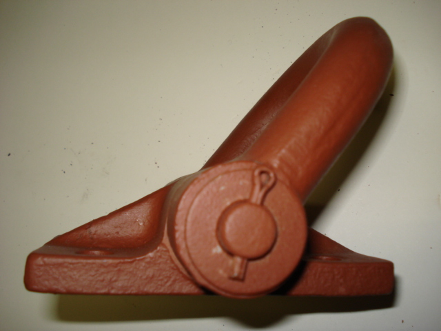

Is it possible to find a new wire guide/D towing eye? otherwise can any one take some closeup picture of one so I can recreate mine.
At the moment there is a normal one bolted on top of original one.

Default Winch Fairing Info
Hi Niels
Take a look at the photo from the parts book, note that the top and bottom shafts and rollers are the same part numbers. So you should be able to fabricate a new lower shaft based on the top shaft.
Bottom shaft was missing on my Patter 12 as well.

Default front towing clevis
Niels,
Here some pictures of my front towing clevis (D-eyes) left side.
GM was using a pin with round head and a washer with cotterpin on
the underside.Ford was using a hex bolt with castelated nut and cotterpin.
Hope this help.

Default right front towing clevis
and that's the one for the right front side.

Default Mix of Chevy and Ford Parts
Hi All
I forgot to mention that the parts break out I posted for the front Winch fairing was Ford. But my Pattern 12 C60L is of course a Chevy, CMPs are often a wonderful mix of parts both some of this is from swapping of parts for repair purpose but much of it is as built. In a what today would be rare cooperation between manufacturing companies FORD and Chevy seemed to swap parts and more important manufacturing capacity back and forth, to get the job done.
Old 29-10-13, 19:03

Thank you guys.
Yes they must have mixed because the towing clevis on my CGT are the ford type with hex bolt. one of the bolts are sadly broken
