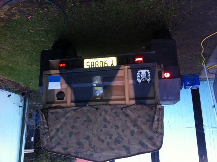

I also brought myself a cooks Trailer.
I figured if I am going to have a trailer I might as well have an ex military one.
I dodgied up some unit plates for that as well.
The trailer is ex 1st sigs regiment according to the stickers on it . So I made some AAVA plates and what i understand to be the Sigs colours.
I now need some kind of canvas treatment for the cover ...and to keep my eye out for a new one .

is just me, or are the pics upside down?

Default Upside down
Seem to be OK in your post... must be something to do with being downunder.
Your right, Gina posted it for the Canuck’s to view!

Old 07-08-13, 05:11
Default Catering for all types
There you go. For you other blokes O.S., we can do pictures for you where ever you stand. Is there anyone around the corner who wants them sideways?
( we're adaptable down here)
