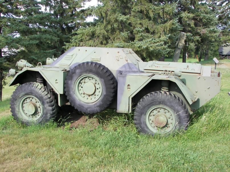

Here is an image of the Wainwright Ferret that I took in 1989.

According to the records I have, DND related the CFR number to the British vehicle number which was located on the data plate. As has been noted, Colin Steven's list of CFRs to serial numbers is unfortunately incomplete.
As an example:
82505 was 35BA63 from my list and SN 289.B.2.4 from Colin's.

On looking at the Wainwright ferret, I think I would have to look at it in person again to be sure it is ex-Cdn. There is an item or two that looks suspect on this one. It would not be the first time that a British one is redone to represent a Cdn one.
The one in MooseJaw falls into that category. It was a British mk2 which was re-done to represent a Cdn example.

Old 21-07-15, 06:32
One of the common things I will look for is the modification to go from the Brit fire extinguisher to the ansul extinguisher. It required the welding of new blocks in the area of the front and the side extinguisher. Neither the Borden nor the Wainwright Ferrets show this modification. So while the rear plate of the Borden ferret shows the likelihood of being Cdn with the (easily drilled) holes drilled for Jerry can Brackets, it does not show the mods for the extinguishers.
There are other mods to look for, but neither photo shows the required areas clearly.

Here's a couple more of the Wainwright Ferret.
