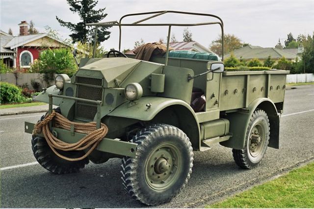

Default New discovery
Just got an e-mail from one of my bloodhounds in New Zealand. They've turned up another Portee. That makes seven now! This one is unusual in that it still retains the rear body from conversion to a GS truck, all the others have had some kind of Civvie/Commercial flat deck fitted. No data details yet, but rest assured it is being sought.
Old 16-11-04, 09:41
David_Hayward (RIP)'s Avatar
former Resident Historian
Posts: 3,841
Default Converted when?
Tony, I am fascinated...I wonder if we can find out whether this was a NZ conversion or whether this was carried out in the UK? I assumed that all the Portees that arrived were ex-Mid East and arrived as built.
