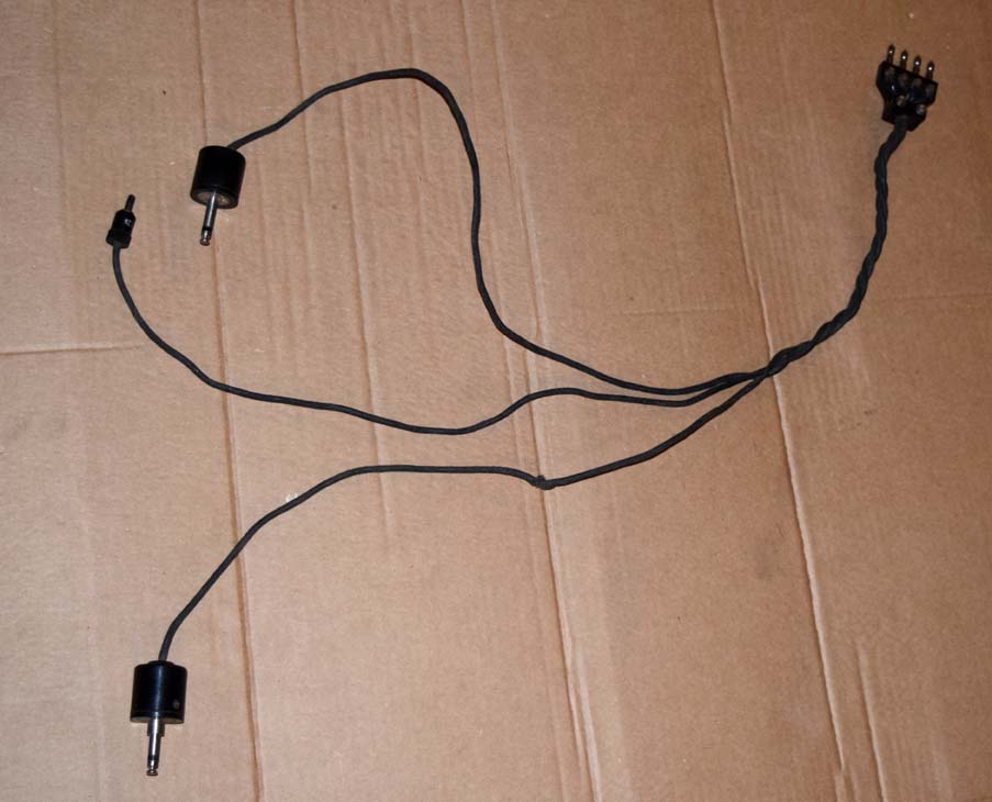

Somebody wanted the switchboard pretty bad. Over $1000. At least we have some pictures now.
Here's some pics of the remote connector. The numbers are the exposed wire lengths in inches.
The 31 inch one is two wires.
The wires are twisted together for 10 inches.

I don't even have the connector assembly (or the webbing strap with pouch) for my own remote control unit 'A'.
The connectors are simple enough: No.9 plug for the headset, No.10 plug for the microphone, and what I assume is a WW2 vintage banana plug for the morse key (sharing the earth connection with the headset and microphone).
I can almost certainly find you the No.9 and No.10 jack plugs (and the actual specification of the connector cable from the VAOS and/or handbook).
