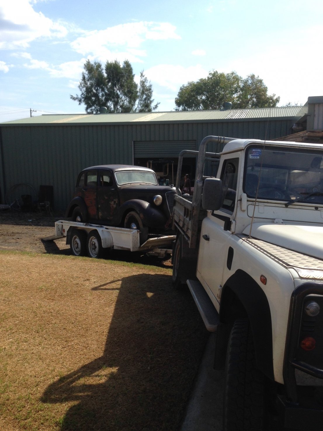

Having finally got all the Tilly photos on to a computer that is easier to load on this forum than using an Ipad it is time for an update and a few more 'before' photos.
Chris aquired over a peeriod of about four months either complete(?!) or the remains of a total of four Morris Tillys out of what we beleive was forty that came to Australia. All so far have been 'knockdown' versions with removable rooves. There was enough to complete two vehicles as detailed above. To date we have completed the rebuild of two rear axles, front axles, two sets of springs, tailshafts and steering boxes. Out of the total of about ten complete sets of front and rear springs I salvaged enough leaves to reset two complete sets. Many of the leaves were broken or had splits running lengthwise, which I had never seen before. Many hours of hammering to reset the leaves sand blasting and reassembly.

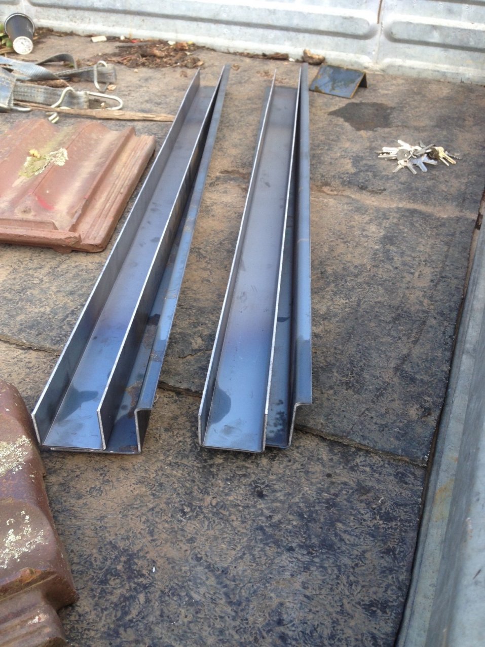

This is the sheet folded up to re-enforce the rear for the tow bar. Everything is done X 2 as both Tillys will be the same.
