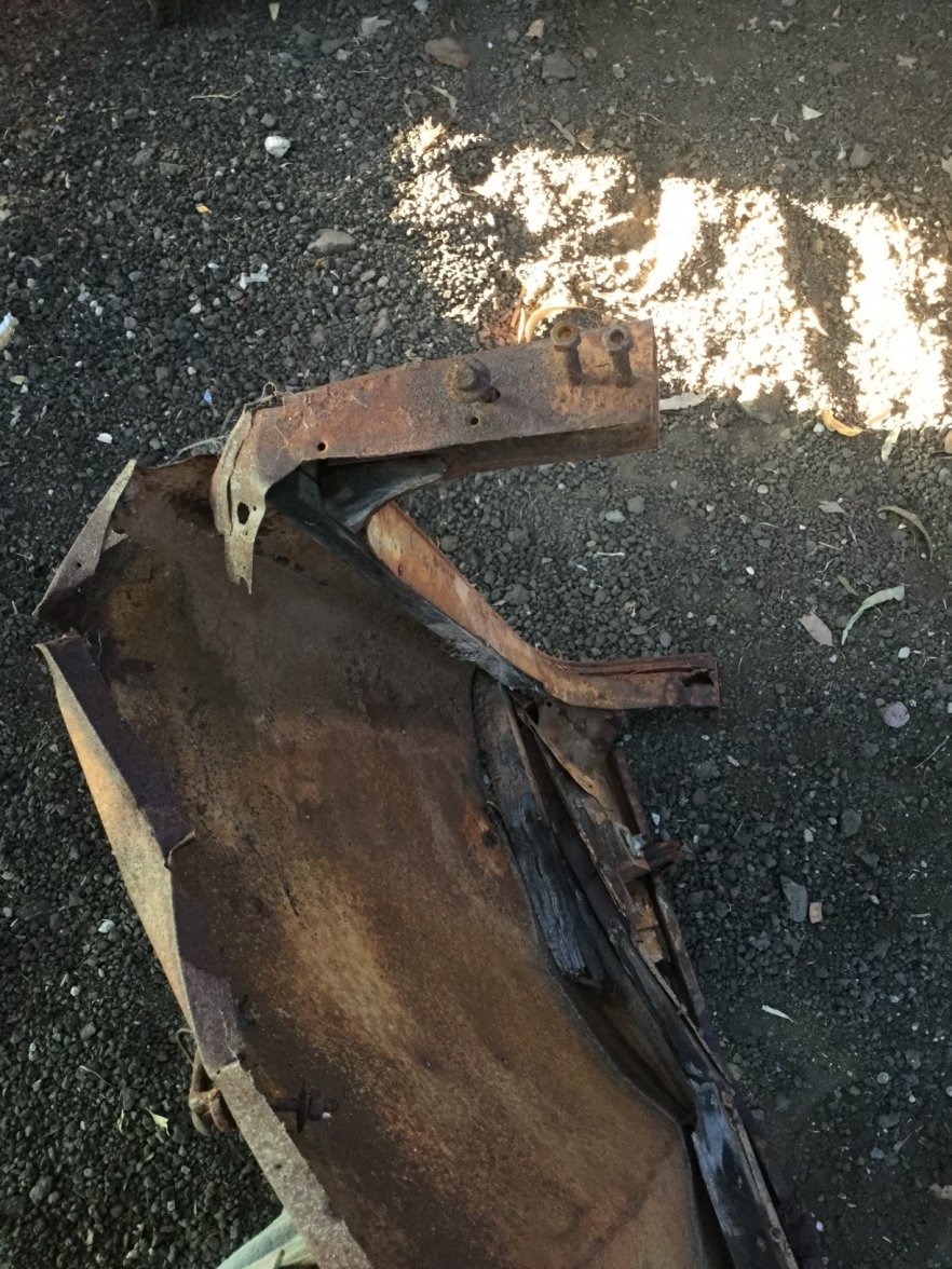

Having finally got all the Tilly photos on to a computer that is easier to load on this forum than using an Ipad it is time for an update and a few more 'before' photos.
Chris aquired over a peeriod of about four months either complete(?!) or the remains of a total of four Morris Tillys out of what we beleive was forty that came to Australia. All so far have been 'knockdown' versions with removable rooves. There was enough to complete two vehicles as detailed above. To date we have completed the rebuild of two rear axles, front axles, two sets of springs, tailshafts and steering boxes. Out of the total of about ten complete sets of front and rear springs I salvaged enough leaves to reset two complete sets. Many of the leaves were broken or had splits running lengthwise, which I had never seen before. Many hours of hammering to reset the leaves sand blasting and reassembly.
Old 07-08-16, 14:56

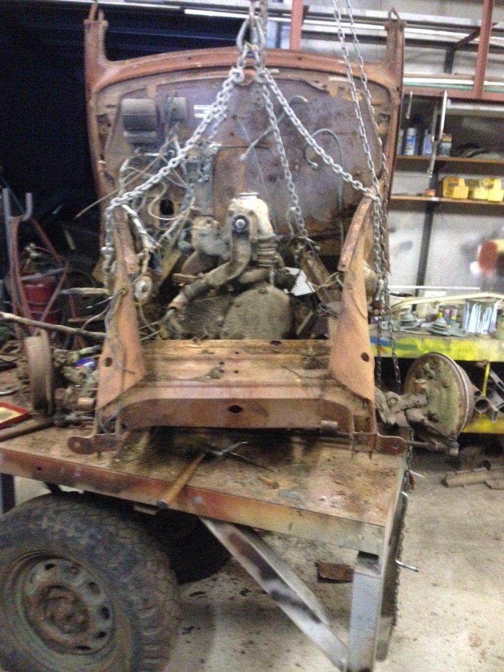

We were short of an engine with this original Tilly hence the lead to Len Watkins and the purchase of the complete Tilly plus the remains of a second which had a complete engine still in situ. We got the complete vehicle running, and the engine was stripped from the othe remains.
Old 07-08-16, 15:12
Join Date: Jun 2010
Location: leopold, victoria
Posts: 1,035
As you can see I have a very robust portable workbench and overhead gantry. It was easier to lift the front hald up in the air and drop the engine out from the chassis. Bit like slaughtering a beast. That front half is not much good but wil provide a few bits and possibly some rust repair patches before its carcass hits the scrap heap.
